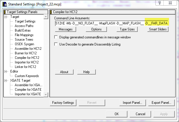

HI!
       I read start12.c,how do I know some marco is open or not? ex: #if defined(__HCS12X__) && defined(FAR_DATA), then how do I know that '__HCS12X__' and 'FAR_DATA'  are defined or not ?

Hi Chen,
'__HCS12X__' is defined in CPU definition. See below:
in above picture step 6,
__HC12__: always defined
__HCS12__: defined for the -CpuHCS12 and -CpuHCS12X options
__HCS12X__: defined for the -CpuHCS12X option
__HCS12XE__: defined for the -CpuHCS12XE option
By default, __FAR_DATA is not enabled. If you need enable __FAR_DATA, we can define it in compiler command line arguments. see example:
