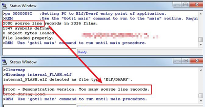

HI.My program encountered the following issues.
When my code source line exceeds 5000, the program will report an error.
As shown in the following figure.

Hi @KAIH1
The problem is caused by license.
What type of license do you work with? free version or professional version or other else?
Jennie
