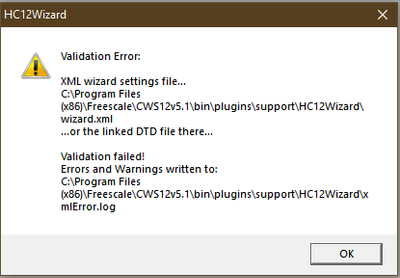

Suddenly, CW 5.1 stopped working and the following message appears.
Now I cannot use my projects.
I have unistall and reinstall CW 5.1 but the problem remains.
Any ideas?

I have installed CW 5.1 at "C:\" and now it works.
For some reason, the installed CW 5.1 at location "C:\Program Files (x86)\Freescale" cannot work.
