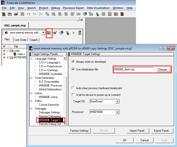

I'm trying to build a project on my computer (Win 7 64bit) that was created on a different computer.  Both computers have CW 8.3 (About says 5.3, what's with that anyway?) but the tool was installed in a different folder on my computer.  The project builds without error but when I try to debug I get an error in a dialog box that says "Could not open config file" along with a lengthy path that ends with 568006_flash.cfg  The path begins with "c:\Program Files" which is where CW was installed on the other computer.  CW can't find the file because the installation on my computer is in  "c:\Program Files (x86)".  I suppose I could copy the Freescale folder from Program Files x86 to Program Files but is seems like there ought to be a way to debug a project created on a different computer without that kind of trickery.  Anyone know how to fix this easily/correctly?

You can try loading that configuration file for the debugger by forcing a full path. Go to Project settings -> Debugger -> Target Settings, and in the initialization file box browse for the correct file in your installation. Please check the next image:

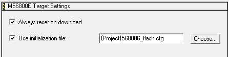

The file you are looking for is inside of M56800E Support\initialization. The inconvenient is that if you get back to the other computer, the error will arise again. To avoid that, you can copy the file to your project folder and reference it from there with "{Project}". Something like:
