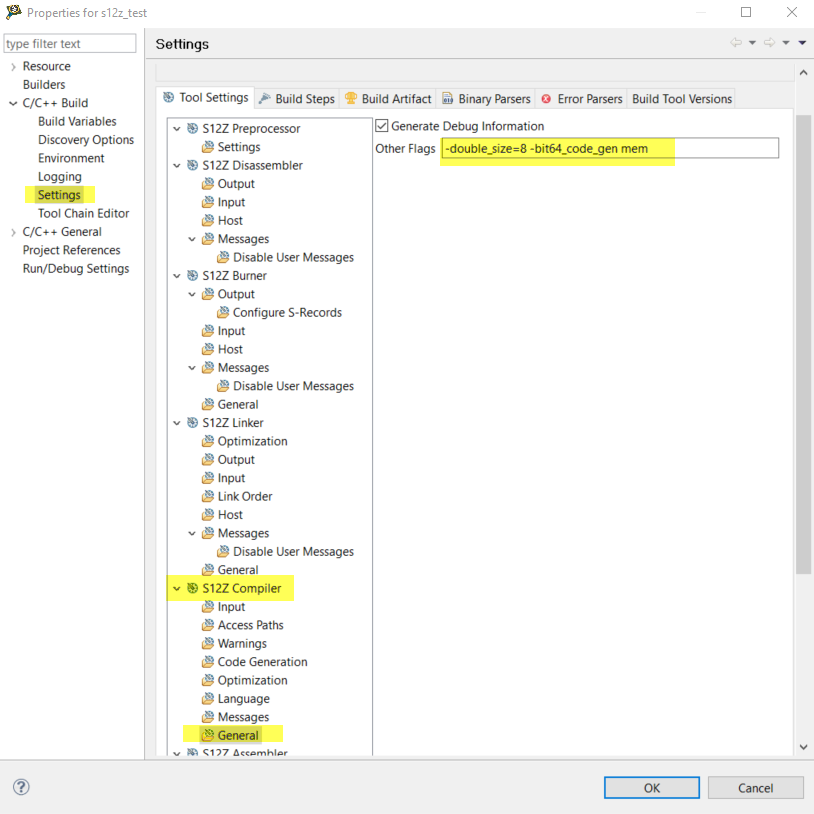

I am using codewarrior 10.7 for MC9S12ZVC and i am facing issue in reading double value it can support only float of 4 bytes ,how can i activate and make use of 64-bit data types in the already existing project

Hello Sujendra Narayana ,
Try to add the blow command in S12z Compiler ->General ->Other Flags:
-double_size=8 -bit64_code_gen mem
Hope it helps
