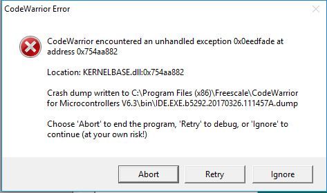

Typically you will get the error "CodeWarrior Development Studio for Microcontrollers v6.3 is not compatible with Windows XP 64-bit installations" when trying to install under Windows 7/10 x64.

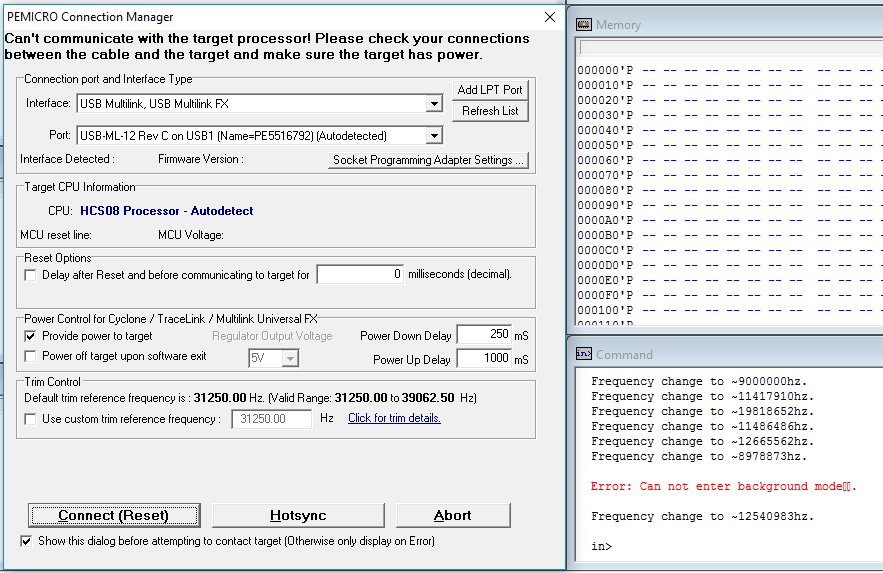

tran_yong
Hi Rodney,
Sorry for the late reply. I did followed every steps, and I am able to use the Codewarrior. I reinstall the Driver For PEmicro many times, but it still have  problem with the Undetected message as shown above. What can I do? I am able to write the code but unable to debug or upload the code to the micro-controller by using Cylone Pro or Cylone Max. Please help.
8,127 Views
RodneyMcGee
Did you do the patch:
2. According to this FAQ, download this zip Patch for CFV1/S08/RS08/MON08 3rd Party Software  extract it and follow the rest of steps in the README text file.
(Basically you need to merge the files from inside the "Patch" folder in the zip into "C:\Program Files (x86)\Freescale\CodeWarrior for Microcontrollers V6.3\prog\P&E". If you do it correctly, it should prompt you about overwriting a few files, do it.)
This is not covered in the video.
8,127 Views
tran_yong
Hi Rodney,
I did the patch as you suggested, but Codewarrior 6.3 still does not see the Cyclone Pro that I used. I have no problem with Codeworrior 6.3 on my Windows 7 laptop. I tried Codewarrior in both of my Desktop Windows 10 64bit and 32bit operating system. I still have the same error no matter what I do.
8,127 Views
RodneyMcGee
Can you post a screenshot of the P&E connection window inside programming interface in CW 6.3?
Can you post a screenshot showing Windows device manager and the properties for the BDM device.
Have you ever tried to use a open source USBDM? They are very inexpensive.
8,127 Views

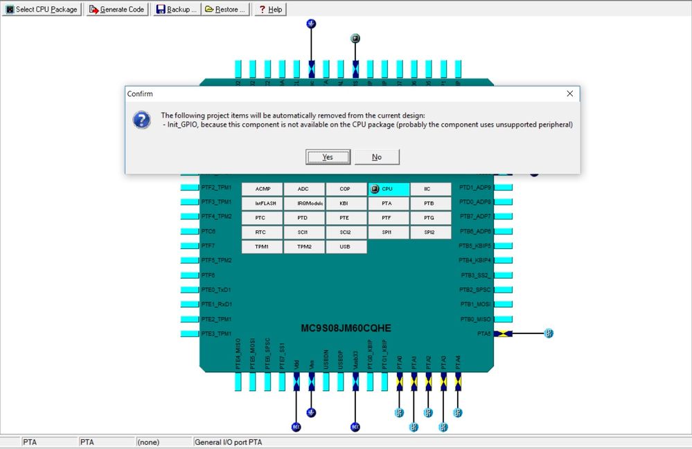

fabiopiccari
Hi All,
my name is Fabio and I'm working with an 8 bit microcontroller MCS08JM60CQH.
I have installed Codewarrior 6.3 on Win 10 Pro.
I had the same problem above with the Processor Expert.
I replaced the PE_Plugin.dll and it solved the problem.
But now when I try to set any port of my device I get the message in the picture below.
It is not possible to set any port of the device from PTA to PTG.
It is possible to set other interfaces like SCI, TMP, ...
Thanks everybody for this discussion that helped me alot,
Fabio.

markmcmillen
It works!  Thanks.  I had to reboot after installing the new plugin, but it no longer crashes on exit.
8,128 Views
markmcmillen
Thanks for posting this.  I have a problem when I run CW 6.3 with PE 3.09 on my Windows 10 machine with Processor Expert.  If I suspend PE or close CW it crashes.
If I create a project without PE I can exit cleanly.  Any help would be greatly appreciated!
8,128 Views
RodneyMcGee
I added a fix for this, in the first post.
You have to update PE_Plugin.dll

fredericbailly
Thank you for this tutorial. Unfortunately I still have one problem left that I cannot solve: Error: Can not enter background mode.
I had no problem with Win7 64 bits, but ever since I upgraded to Win10 I cannot connect to my HCS08 microprocessor using USB BDM Multilink Rev. C.
I have re-installed CodeWarrior 6.3 following all the steps described above, ran all the 12 update packages, intalled the latests PE Micro drivers, copied the files from P&E CW 6.3 full fix and rebooted Windows, but still the BDM cannot connect.
Is there something I have been doing wrong??
Thank you for your help!
8,128 Views
RodneyMcGee
After talking with Fred, it seems his P&E multilink had a hardware issue (it didn't even work under XP). So I think this is resolved. Thanks for letting us help you with this. :smileyhappy:
But, after talking with him, I thought I should update the video on the top post to include a complete walkthrough showing programming with a chip with CW 6.3 Win 10 64-bit with a P&E maroon multilink (USB-ML-12 Rev. C). The Rev. A is not compatible, so check the bottom label. I hope this clears things up.
