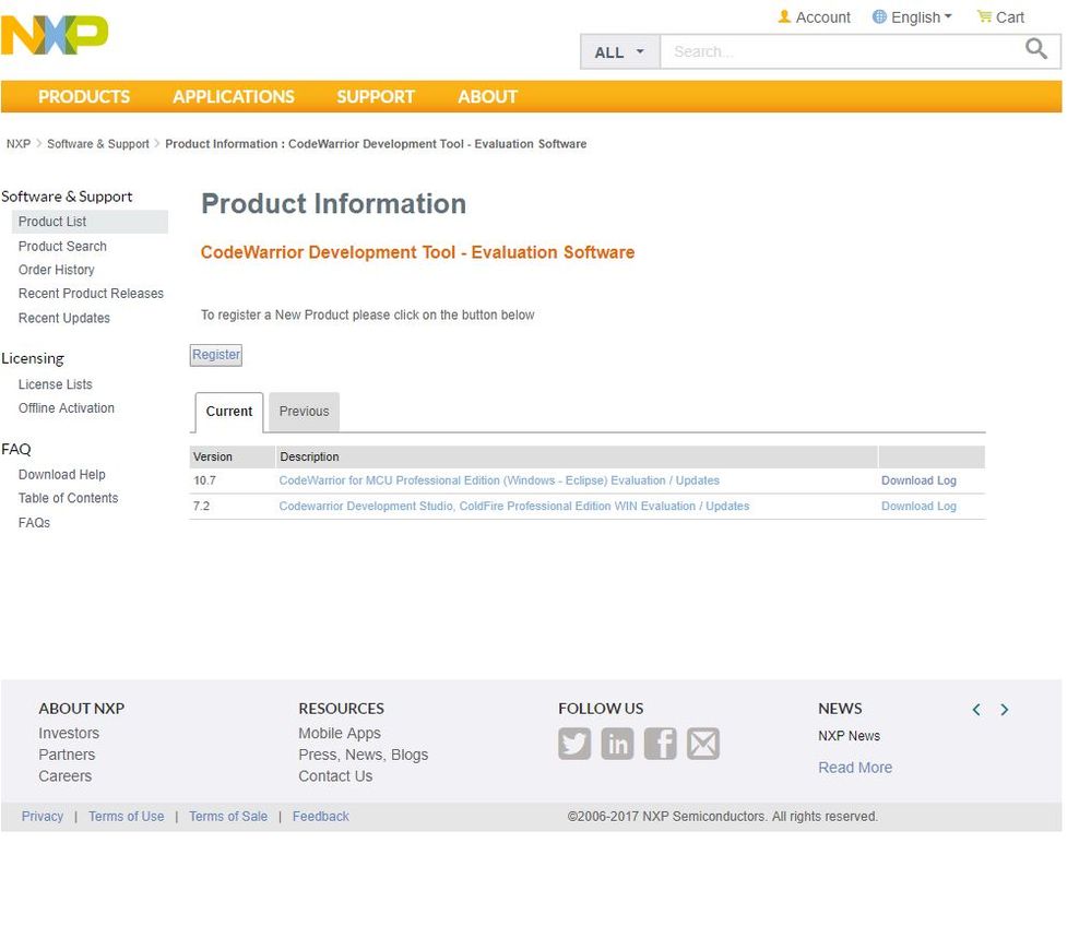

jerry_rubinow
Hi Jennie,
When I go to that page, I only see the products for which I downloaded an evaluation copy (see attached screen shot).  I do not see the "NXP Software" link.
Jerry
3,523 Views
ZhangJennie
Hi Jerry
Normal This is because you never purchase a license. Thus you can only download evaluation license.
