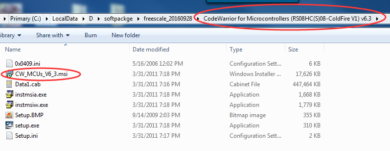

I have tried to install "Codewarrior v6.3 for micro-controllers in my Windows 10, 64 bit system and followed the procedure as per NXP provided How-to Directly Install CodeWarrior 6.3 Classic in Windows 7 & 10 x64 (Unofficial Method) .  I have downloaded "CodeWarrior for Microcontrollers CW_MCU_V6_3_SE.exe" file and using 7Zip,
I have extracted the files, but I could not find " CW_MCUs_V6_3.msi    " file to run RemoveOSCheck.
Please let me know, where can I find/ get the   CW_MCUs_V6_3.msi file, so that I will use the same in my system CodeWarrior v6.3 installation.

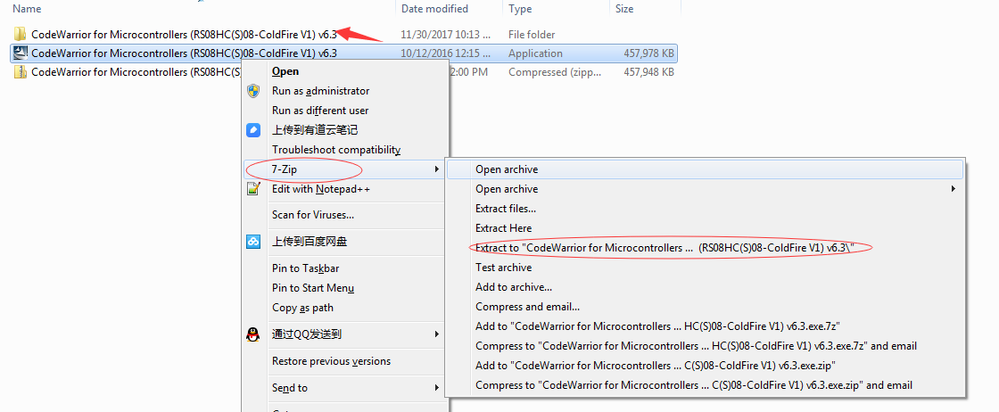

Hello Srinivasu Batchu,
Please extract the CWv6.3 .exe , in the compress folder , you can find CW_MCUs_V6_3.msi
About the detail please have a look at the video that install guide mentioned :
NXP Freescale CodeWarrior Classic 6.3 Windows 10 & 7 x64 64-bit HCS08 RS08 CFV1 P&E Multilink BDM - ...
Hope it helps
