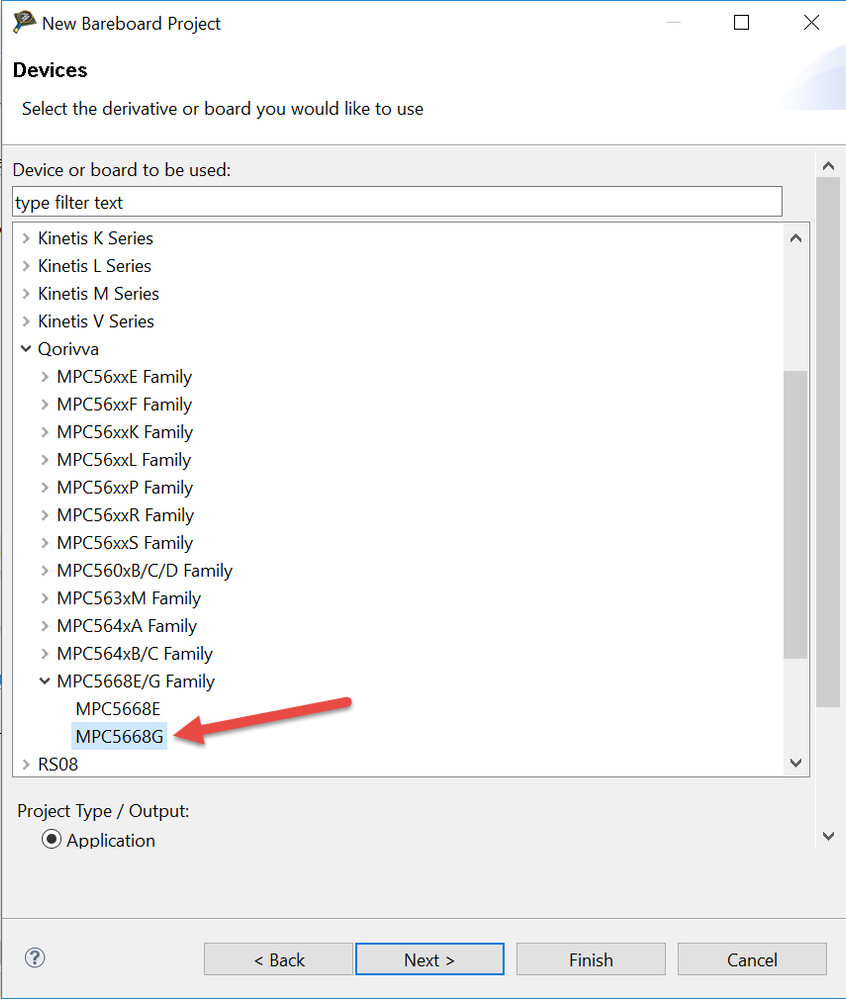

Are Qorivva® 56xx and POWERPC 5668G both are same?
Because in this tool, I didn’t find an option to select the target from POWERPC.
Sukruth
27,072件の閲覧回数
ZhangJennie
yes, when you create a new project with CodeWarrior11, you will see MPC5668G here
