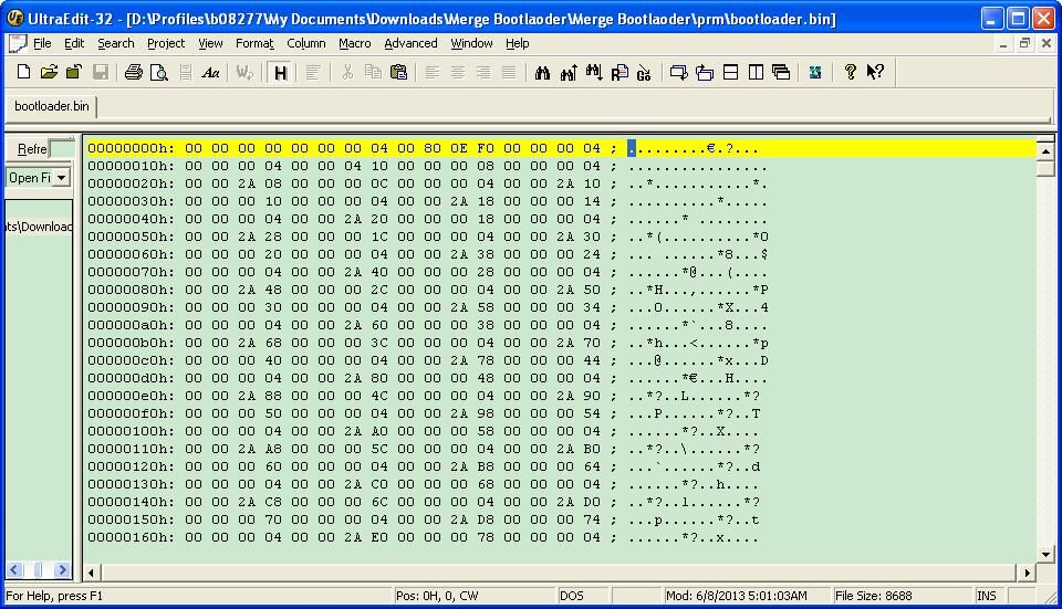

I checked your project bootloader.bin with UltraEdit, this is the content:

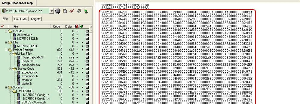

in you lcf file, you use INCLUDE command to include the bin content start from 0x410. after build the project, it insert to 0x410 well. see the generated project.abs.s19 file:
so we can say that INCLUDE command has performed the function well.

The problem is probably related to the fact bootloader.bin includes some data prior to the address 0x410.
This is visible in bootloader.s19 which starts at adress 0x0000_0000. These are probably interrupt vectors starting at 0x0 to 0x198.
I'd suggest you to manually cut off the interrupt vectors (in case you don't use interrupts in the bootloader) from bootloader.bin file (I modified the file using hex editor - result is attached) and then try to rebuild/relink the project using the updated binary file.

I use the bin file you provide. If the condition to enter the bootloader is not met then it execute the user code and works like a charm. But If I'd like to enter in bootloading mode, then it crash. So I decided to step the ASM code until it crash and I've notice something very very odd that is causing the problem: INVALID OPCODE at assembler window.
So I load the bootloader alone to FLASH and then in memory window go to address 0x508 (where the invalid opcode was) and this is what I've got:
@0x508: 00 80 00 00 07 00 46 C0
Then, I load the code with the merged bin and at the same address, I've got:
@0x508: 00 80 00 00 00 00 05 0C 00 00 00 FC 07 00 46 C0
Notice that 8 bytes (in red) are added before what should really be there and that is the INVALID OPCODE. I open the bin file you provide, with and Hex editor, and find out that those byte are part of the bin. (If you'd like to open the bin file, go to address $508 - $401 = $F8 and there you'll see it).
Those bytes seems like some "mark", pointing to 0x50C. Then I open the bootloader S19 file and found out:
S321000004F04FF900800EF02C7C000000004E5600004BF90080000440C00080000090
S3210000050C070046C061FF0000009661FF0000005C717C008041FA0004D1FC000095
What's going on here?
