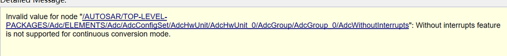

Dear all,
I have a prolem, when I use the MCAL4_3 , I configurate the ADC,but It has the error.
When I choose the continuous mode and "without interrupt" mode, it has an error that:without interrupt feature is not supported for continuous conversion mode.
Do MPC5777C   must use interrupt mode about continuous mode?
Or there is a problem about MCAL4_3?
6,349 Views
Ada_Lovelace
I have solved the problem.MCAL4_3  version has the bug , update the MCAL4_3  , ADC calibration makes it work.
