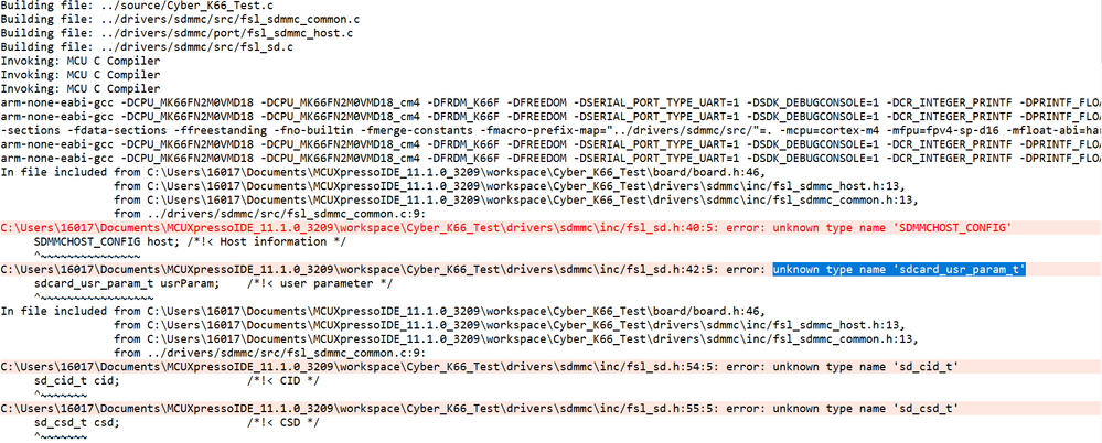

unknown type name 'sdcard_usr_param_t'

Hi!
While I copy the fatfs and sdmmc folders to my own project and build it, this situation comes up. I have already included the necessary headers but it somehow cannot be recognized. Here are the screenshots of my project.
Thanks!
Best Regards!

Hi Yuanyi:
I would suggest you check the order of the header files.
