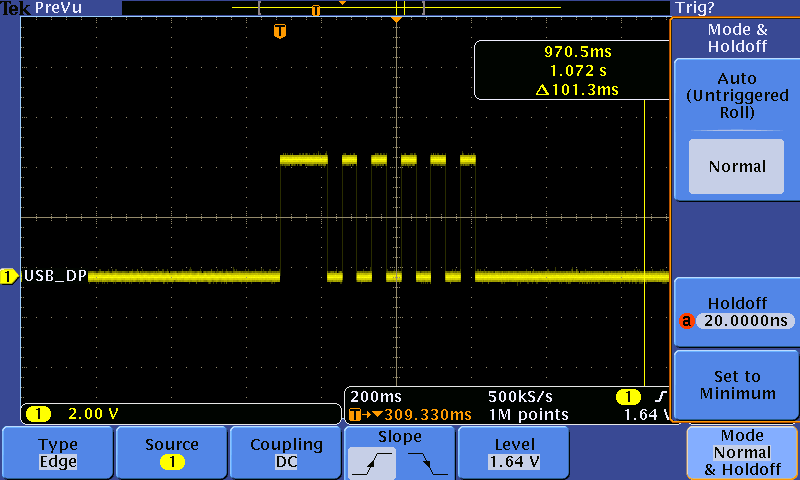

weapon
Senior Contributor I
Hi Konstantinos,
The modules in S08SE and S08PA are different, but now I suppose I misunderstood the issue you met in S08SE. I just do some test in S08P family,
below is the code.
void FTM0_Init(void)
    FTM0_SC = 0;
    FTM0_C0SC = 0;
    FTM0_C1SC = 0;
    FTM0_MOD = 0xFFFF;
    PORT_PTDIE_PTDIE6 = 0;
    PORT_PTDOE_PTDOE6 = 1;
    PORT_PTDD_PTDD6 = 0;
     FTM0_SC = 0x4C; // start
// Interrupt Service Routine
ISR(IsrFTM0OVF)
// NOTE: The routine should include actions to clear the appropriate
//      interrupt flags.
    static byte overflow_count = 0;
    byte dummy;
    dummy = FTM0_SC;
    FTM0_SC_TOF = 0;
    FTM0_MOD = 0x5000;
    overflow_count++;
    if(overflow_count == 6)
    if(overflow_count == 12)
        FTM0_SC_CLKS = 0;
    PORT_PTDD_PTDD6 ^= 1;
In the ISR, I toggled one GPIO to be monitored by  an Osilloscope.  I got below waveform:
We can see the first period is still 0xFFFF, and FTMxMOD is updated at the first falling edge(the second overflow interrupt).
Is that what you observed in S08PA?  Could you share the waveform got from S08SE?

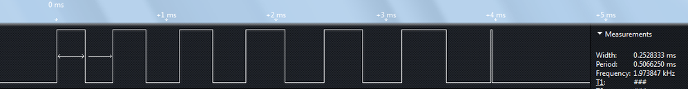

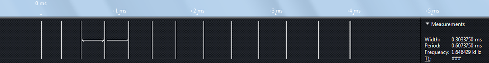

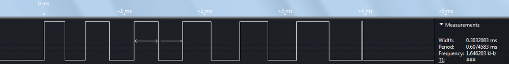

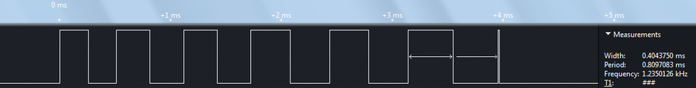

konstantinoshal
Dear Xu,
Please run the following example to a MC9S08SE4 controller. You should see the results as per attached images.
void main(void)
    PTAD = 0x00;
    PTADD = 0xFF;
    ICSTRM = 0xb9;
    ICSC2 = 0x00;
    TPM1CNTH = 0;
    TPM1MOD = 500;
    TPM1C0SC = 0x28;
    TPM1C0V = 250;
    TPM1SC = 0x4B;
    EnableInterrupts;
    for(;;)
        __RESET_WATCHDOG();
interrupt VectorNumber_Vtpm1ovf void isr_Vtpm1ovf(void)
     static unsigned int TPM1MOD_BUF;
     static unsigned char i;
     TPM1SC;
     TPM1SC_TOF = 0;
     TPM1MOD_BUF = TPM1MOD;
     TPM1MOD_BUF += 100;
     TPM1MOD = TPM1MOD_BUF;
     TPM1MOD_BUF >>= 1;
     TPM1C0V = TPM1MOD_BUF;
    if (++i == 4)
        TPM1SC = 0;
As you can see, between overflow interrupts, there are two periods. Notice, that in overflow interrupt the PWM
period is changing by altering the TPM1MOD register. The initial period is 500 usec and in each overflow interrupt
is increasing by 100 usec. So, the expected values would be: 500 -> 600 -> 700 -> 800 usec. Instead we see that
the output periods are: 500 -> 600 -> 600 -> 700 -> 700 -> 800 etc.
screenshot.pngscreenshot1.pngscreenshot2.pngscreenshot3.pngscreenshot4.pngscreenshot5.png
I hope everything is clear now.
Do you think that this is an abnormal behavior?
Konstantinos.
