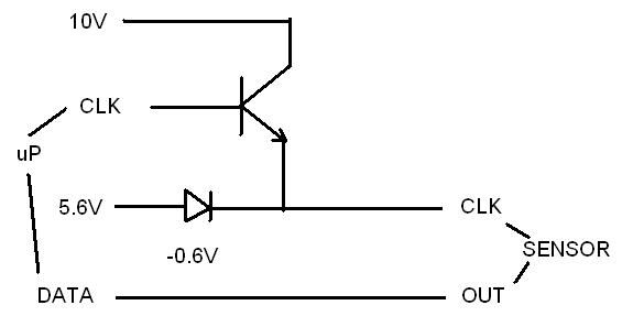

Thank for you idea of schematic, I'll think about that for a programmer of the TLE7998
(Actually,we use the Hitex one and this is a nightmare)
But the Infineon link above is only for programming the sensor once at production of the board
(amplification, offset, cutoff filter etc ...) This is done only once
After, when the sensor is running normally, the sent protocol is measurement of length of pulses
One 56 Unit Time pulse (~168 µs but not so accurate) then 8 pulses of 12 to 27 UT and I have to
calculate the length of these 8 pulses and then the Crc (which is very simple)
I my case (SG32 36 MHz, measurement and storage of pulses takes ~1 ms
decoding the length ~1 ms also. This could be ok but I think that with a 16 bits processor it could be improved
much more. I continue my investigations, but it runs not so bad ....

Leojunin
Hello, I read a little about the sensor. The clock is driven on the same line VDD, changing the voltage. Then it is a covert means SPI. You could make a driver leaving a port of any microcontroller. Using 2 pin. You can make a driver to control it. I imagine a transistor hung from the connector to 10V and its emitter fed from 5.6V with a diode which fall 0.6V and thus feed sensor handle and turn the clock.
Everything goes through the imagination. When I made the ISO14230 protocol, I used a QY4 @ 4MHz fbus.
You should read carefully and more than once the sensor data sheet.
