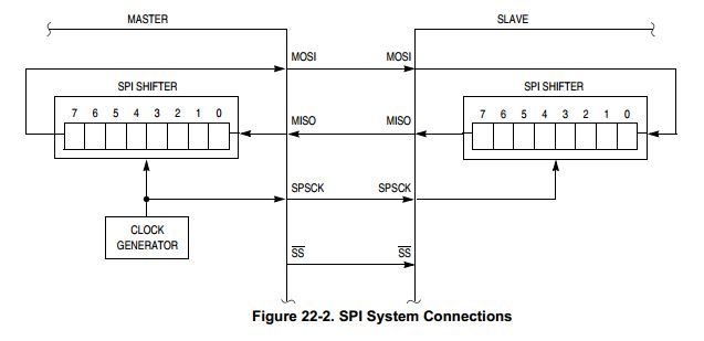

I'm learning about SPI and how use the registers.
I have initialized the module as slave mode
I suppose when the master wants communicate with the slave, the slave will get the data via interrupt.
My question is.  When the microprocessor get in the Vspir  interrupt, he can send information to the master?
the other question is if i have wrote well  the interrupt code for the slave. (code below)
interrupt VectorNumber_Vspi void Vspi_ISR (void) {     byte data;                 while (!SPIS_SPRF){};  // Wait until the next byte is received      data = SPID;     pixels[0]=data; }

Hello Carlos Omar,
The following figure shows the SPI modules of two MCUs connected in a master-slave arrangement.
During a transfer, the master shifts data out (on the MOSI pin) to the slave while simultaneously shifting data in (on the MISO pin) from the slave. The transfer effectively exchanges the data that was in the SPI shift registers of the two SPI systems.
After this exchange of data, an interrupt may be generated.

carlosomarharoc
Hello David, Thanks for reply.
Now my SPI Master-Slave  works in  9S08AC60.
I was trying Master-Master(fault mode). But i think that arrangement is imposible. When I debug it  the Master with fault mode  always stays in slave mode.
But my code in master-slave works now, thanks alot.
