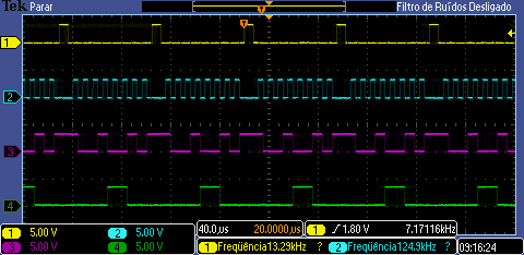

Hello guys, I'm having problems with the CPI EN 60.
Below my boot code, reading and writing.
Also follows signal aspect I need to generate.
how to get my signal.
like this my sign.

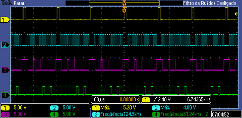

your code is OK, but it is set for 8-bit mode os SPI module. If I understand well, you want to use 16-bit mode like on picture_1, instead of 8-bit mode on picture_2.
You need set SPIMODE bit in the SPIx_C2 register to use 16-bit mode. Then the 16-bit value will be send/received from/to SPI module.

Stano Hello, thank you for your attention.
I'm using the SPI0, and when I set the SPI0_C2_SPIMODE = 1, the error occurs: C1815 SPI0_C2_SPIMODE not declared (or typename).
It is only SPI1 can be configured to 16b?
2,599 Views
kef2
Senior Contributor V
Yes, according to S08PT block diagram, SPI0 is 8-bit module and SPI1 is 16-bit module.
You can disable SPI0_C1_SSOE and toggle chip select pin from software and do two 8bit transfers (address + data) both when writing to device and reading from device.
