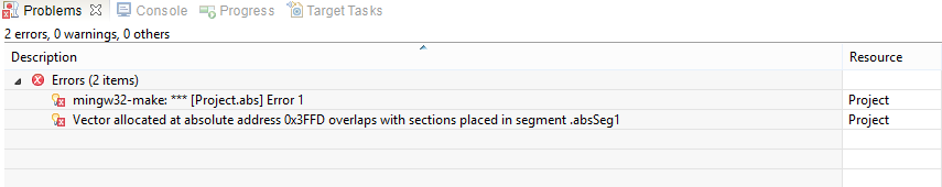

Hi All,
I have try to recompile the code but that it show error in attachment.
Any body known, what am i wrong please advice.
Thanks.
Sonchai M.

Hi Sonchai
Looks like you have missing some file
This is a sample code?
where did you get it?
Vicente

sonchaimalaicha
Hi Vicente,
Thanks for reply.
This is not sample code. so my previous engineer write on code warrior v6.3.
So i'm try to import to new version v10.6 but complied still not success.
So If i skip the command to define : static const unsigned char JMPOpcode  @0x3FFD = 0xBC;  // Opcode of JMP extended
the compile has successful build. but still fail as below.
Do you have any advice?
Sonchai M.

Hi Sonchai,
Which steps did you follow to migrate your project? The cleanest way to migrate a classic project to CodeWarrior eclipse is to create a new project in CodeWarrior 10.6 and then copy your source files to it. Here is a document that explains in detail how to do this:
http://cache.freescale.com/files/soft_dev_tools/doc/app_note/AN4727.pdf
By looking at the error it seems like your project has a duplicated definition for a vector, make sure that you only declare the interrupt vectors (and reset vector) in a single place, in CodeWarrior the reset vector is defined using the below line in the *.prm file:
VECTOR 0 _Startup /* Reset vector: this is the default entry point for an application. */
Let me know if it helps!
