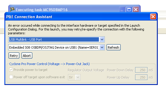

Hello, I have MC9S08MP board and I have problem to upload program on it via BDM. I'm using CodeWarrior 10.6 and when I'm trying debug example program this window appears:118699_118699.pngpastedImage_0.png
When I reconnect it nothing happens. After click OK this appears:
Then it's just error when I click 'Abort'. OSBDM is visible in device manager and all drivers are installed properly.
Please help me with this problem.

Problem solved, It was problem with one of resistors in my board which has short circuit. Thanks for responding!

Hi Pawel,
check the bypass capacitor, there may be a lot of capacity in the power line and prevents micro finalize the POR. It would be nice some 100nF I have not tried more, but if I had that fails. You can skip this failure by setting the Power Down Delay longer. Example: 1S
