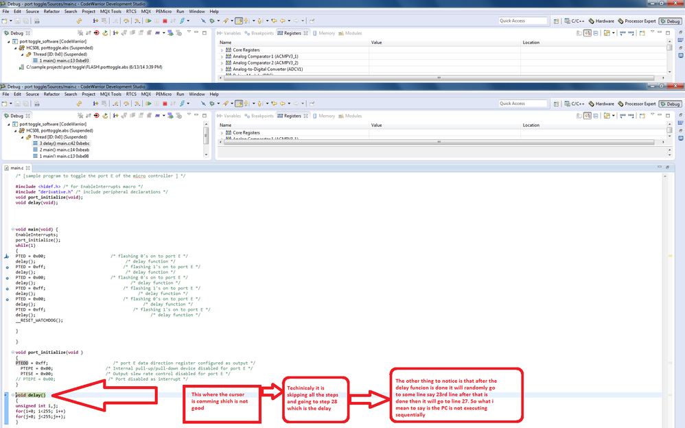

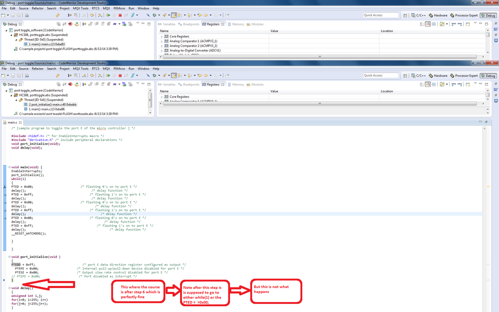

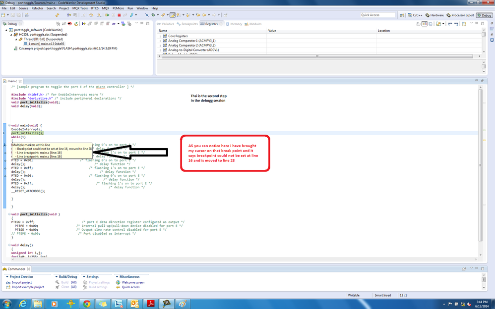

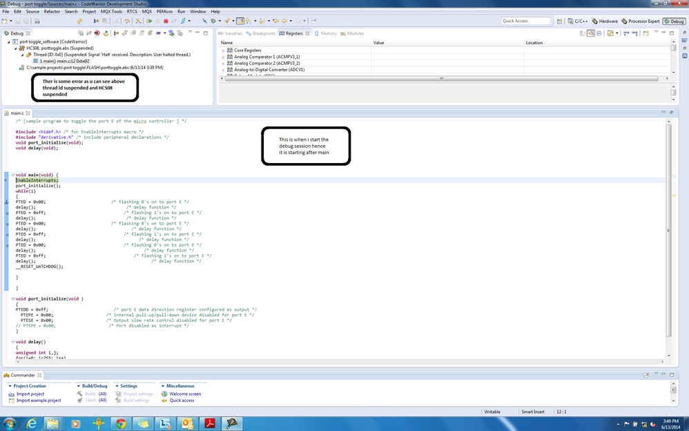

Hi every body i am new bie to this controller and i am facing some problem with my code,
i have written a small code to toggle port E I am able to toggle the port but when i run the code in debug mode and do step by step method the PC is not going set by step it is pointing to random instructions. I have included the code below please help.
/* [sample program to toggle the port E of the micro controller ] */
#include <hidef.h> /* for EnableInterrupts macro */
#include "derivative.h" /* include peripheral declarations */
void port_initialize(void);
void delay(void);
void main(void) {
EnableInterrupts;
port_initialize();
while(1)
PTED = 0x00;                          /* flashing 0's on to port E */
delay();                                    /* delay function */
PTED = 0xff;                               /* flashing 1's on to port E */
__RESET_WATCHDOG();
void port_initialize(void )
PTEDD = 0xff;                          /* port E data direction register configured as output */
  PTEPE = 0x00;                     /* Internal pull-up/pull-down device disabled for port E */
  PTESE = 0x00;                     /* Output slew rate control disabled for port E */
// PTEPE = 0x00;                     /* Port disabled as interrupt */
void delay()
unsigned int i,j;
for(i=0; i<255; i++)
for(j=0; j<255;j++);
Note when i use the port just once i.e make it high and then make it low and delete the rest of the code it works find but when i try to toggle the port again by includeing the port then i am facing this problem.

ZhangJennie
hi vikas,
which line of you do you begin to have problem with? can you please send a screenshot of the probelm?
Zhang Jun

ZhangJennie
hello Vikas,
the problem is due to optimization. the simple way to avoid optimization is to add "asm nop;"
   while (1)
PTAD_PTAD0 = 1;
asm nop;
delay();
PTAD_PTAD0 = 0;
asm nop;
delay();
PTAD_PTAD0 = 1;
asm nop;
delay();
PTAD_PTAD0 = 0;
asm nop;
delay();
                __Reset_Watchdog;
this answer is for you. if it helps, please click on "correct answer" button. thanks!
Zhang Jun
