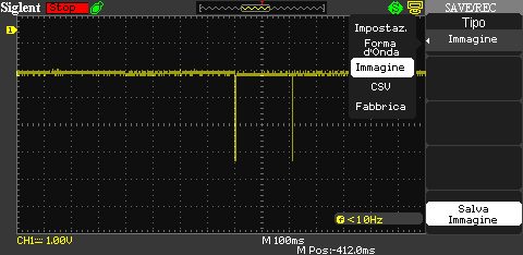

About polling : if use a timer, when timer period expires the node send a message to the master. Then few milliseconds after node sends another message which i can't explain. I looked for an explanation in the code and i found this :
/*Default Timer Value for Time Between the confimation received for any
    request and the next poll request sent by an End Device
    ( The value is given in millisecond )*/
#ifndef mDefaultValueOfConfirmationPollTimeOut_c
   #define mDefaultValueOfConfirmationPollTimeOut_c  200
#endif
analizing the consumption signal with an oscilloscope i measured exactly 200 milliseconds between the two messages. So the node needs to poll the master, right?
