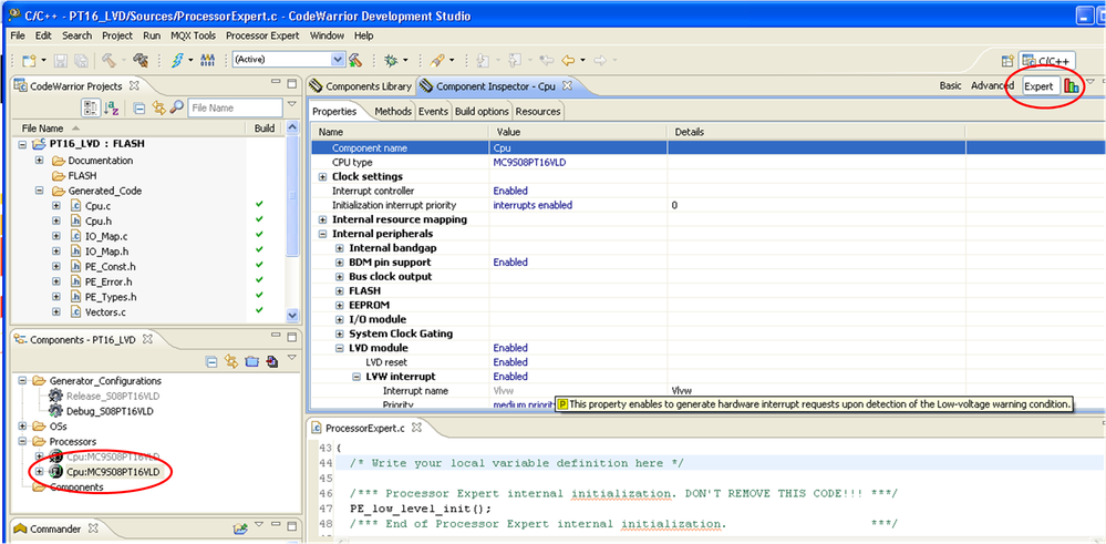

i want to know how to generate LVD interrupt from bean inspector in  MC9S08PT16

Hello Chetan,
LVD Interrupt can be enabled in CPU bean (once the PE is enabled in the project, no need to add any other bean) from the options available in component inspector. To see the list of the options switch to "Expert" view (circled in the image below) of the inspector. Go to Internal Peripherals-->LVD Module-->LVW interrupt to enable the interrupt.

chetan
Dear Arpita
Thanks a lot arpita
Problem solved I don’t know to see it in "Expert" view
