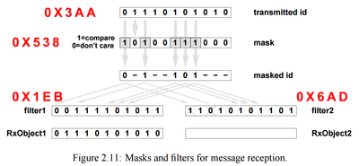

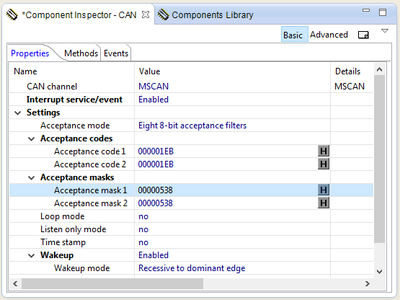

I use IC mc9s08dz96. I want to use a mask and filter to receive CAN IDs. For this purpose, I have used the example in the  image . As it is known, The Transmitted ID is 01110101010(0x3AA), The Mask ID is 10100111000(0x538) and The filter ID is 00111101011(0x1EB). I use The CodeWarrior IDE, in CAN Properties, In Acceptance code 1 and Acceptance code 2,I set 000001EB, In Acceptance Mask 1 , Acceptance Mask 2, I set 00000538. Then I send the 0x3AA from pc to MCU, But this ID is rejected.
When I send 0x00, It is accepted. Does anyone know where the problem is with my implementation?
I followed this example:
 This is my CAN properties:

 Sorry normally I do not use processor expert for CAN communication, I use the samples code under the
msCAN Driver for S08
Also you can use the help on component for PE
