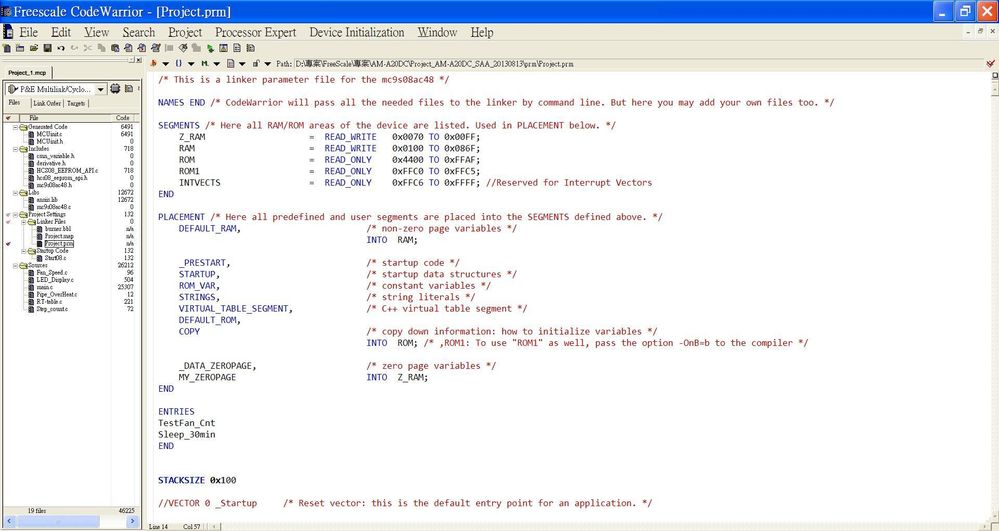

crouse
Thanks, Jennie
But it also can not work after I use the method  :smileycry:
the .prm file as below :
4,295 Views
