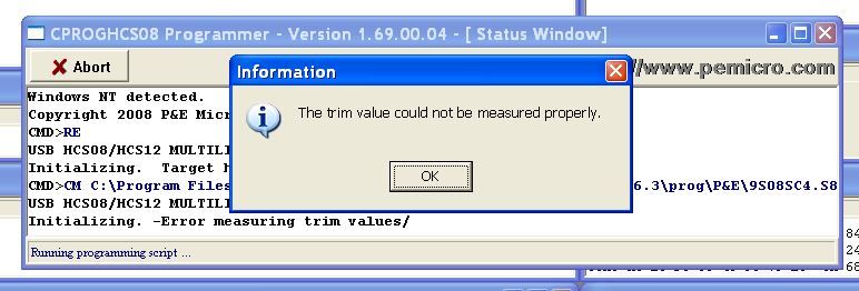

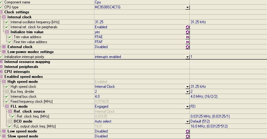

I'm using CodeWarrior V6.3 to modify a very old project for the company I work for. The micro that was used was the S9S08SC4E0MTGR and since it is not available anymore, a replacement was bought whose part number is MC9S08SH4MTG. It is supposed to be practically the same micro, but when I want to load the firmware, I get the error "The trim value could not be measured properly". I read in several forums, resolutions, but I can't understand how to calculate and how to change the trim in the version of CodeWarrior that I have. I don't know much about the subject.

Please accept my apologies for the late response, your pictures of processor expert, it shows the S08SC device, not the S08SH device, this is causing that CodeWarrior is training to load the trim values from the S08SC into the S08SH but those are not the same causing this error, please change the processor to the right one that you are using
I hope this will help you
