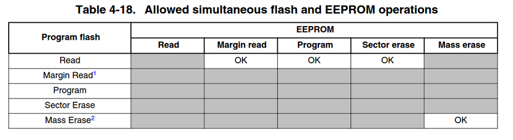

I have a question about the code position for read/write eeprom.
In such cases I have to run the code from RAM ?
I have read the datasheet (Table4-18) and AN4570, but remain a doubt :
When the code is mormally execute in flash, can i read the eeprom value ?
The Program flash Read is considerated also when the code in flash is executed ?
