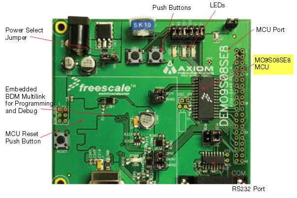

Hello everyone. I am learning how to work with a HCS08 and I need to get information about temperature using a sensor LM35 and programming in C. Does anyone can help me? To be honest I am lost. (sorry for my bad English).

david_diaz
Hello Reinaldo,
In this case, the LM35’s output is a voltage linearly-proportional to the Centigrade temperature.
In order to deal with this output, I recommend to use the ADC Module of the DEMO9S08SE8.
You can find, attached to this response, a sample ADC project in order to read the LM35 output.
Please let me know if you have any question about the code provided. I will be glad to help.

david_diaz
Hello Reinaldo,
I am glad to help . Please feel free to ask any question you have.
In this case, the DEMO9S08SE8 counts with a MC9S08SE8 MCU.
You can find all the material (datasheet, application notes, etc) regarding the MC9S08SE8 MCU at the following link:
8-bit General Purpose SE MCUs|Freescale
I hope this information will be useful for you.
