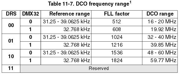

I previously posted abut this issue on the Crystal control clock on the 9s08QE processors and provided a solution there but that solution appears not to work correctly for the s08QB8 processors.
_______________
Using a 10 MHz XTAL, External Osc, FEE will work. RDIV= 3 ( div=256 ), Range=1, produces an accurate 39062.5 Hz Reference Clock. This results in a fixed frequency of 40,000,000 Hz from the FLL, and using BDIV=1 ( div by 2 ) produces a 20 MHz bus Clock.
With this frequency, the TPM can use the buss clock and achieve the desired accuracy and resolution.
Also, using a BDIV=0 can double the frequency but at a cost of higher dissipation.
_______________
When I do this with the QB8, I only get about a 5 MHz bus clock?
Using a 10 MHz xtal ( frequency verified on scope )
ICSSC=$FFAE + #$40
ICSC1=#$18   FLL selected, Ext Source, RDIV=256
ICSC2=#$37 BDIV=0, HF=1, HGO=1, ERCLKEN=1,EREFS=OSC
This should produce a 40 Mhz Bus Clock
or
ICSC2=#$77 BDIV=1, HF=1, HGO=1, ERCLKEN=1,EREFS=OSC
This should produce a 20 Mhz Bus Clock
Either way, The BDM reports 4.99 MHZ to a little over 5.01 MHz varies
Checking out using TPM:
TPMMOD= #$1 ( div by 2 )
TPMSC= #$8 ( Bus Clock used and by 1 )
TPM0SC = #$14 ( Toggle on OVFL )
Produces 1.25 MHz
Have I overlooked something? It works fine with the QE-32 ( actual values slightly different due to module version differences ).

Please note that the Central Processor Unit of the S08QB Series, works up to 20 MHZ as follow:
I assume your application does not work as expected due to the FLL factor corresponding to the DCO frequency range (Table 11-7 - Reference Manual).
The resulting bus clock frequency should not exceed the maximum specified bus clock frequency of the device.
Freescale does not guarantee the proper behavior of the device out of the ranges mentioned on the datasheet.

That is actually the issue that we appear to be having, We can not get the bus to run at 20 MHz.
10 MHz bus runs fine but that does not provide the closk output that is needed from the TPM.

In case you are referring to the S08QB Series, it is not recommended to set the bus clock at 20 MHZ.
Please note that the Bus clock frequency is one-half of the CPU clock frequency.
If you set the bus clock at 20 MHz implies that the Core is running at 40 MHz which is out of the range.
As I mentioned before, the resulting bus clock frequency should not exceed the maximum specified bus clock frequency of the device.

Correction:
ICSC1=#$28   FLL selected, Ext Source, RDIV=1024
Also, when set up this way, it appears that the RTC does not work properly. The RTC is used to update several counters and seems to work ok at lower Bus Clocks but when the Bus Clock is 20 MHz, the system hangs waiting on a counter that does not increment in the RTC routine.
