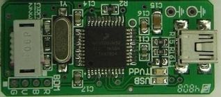

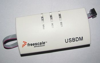

Colleagues here forum can read and program MC9S08DZ32 with USBDM? They know tell me if it really works?
gravador freescale USBDM
4,313 Views
adrianomarques
I tested this, but only identified a MC9S12DG256B
He did not identify the 9S08DZ32
The TCL Interpreter did not connect
