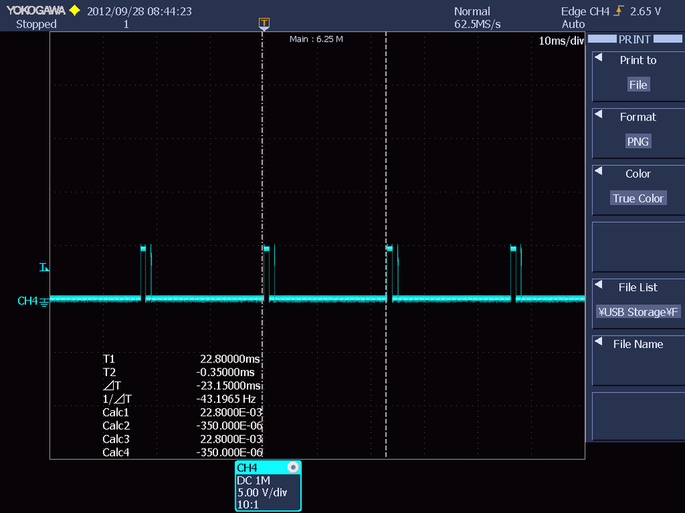

Hi Guys,
I followed the code by the second example (p.6-7). Unfortunately, it never came out the waveform as shown in figure 6. I guess it is the problem of interrupt. Following is the complete codes. Could you please give me some hints to correct the problem? Thanks in advance!
Ed

edjiang
Hello Gang,
Thanks for quick replying. You are right, there are some errors in the code. I corrected these errors and now it looks nearly the same as in the app. note. However, the output waveform is still different from Fig 6. I also attach the screenshoot of the waveform. What would be the reason?
(BTW, example 1 works out exactly the same results as shown in Fig 4 and 5. )

StrongChen
Hi Ed,
The waveform is very weird, I don’t know how it happens. But on the RTC interrupt service routine, RTCSC_RTIF should be written 1 to clear the RTC interrupt flag. Please modify and try whether it can make anything different.

edjiang
Hi Gang,
I uncomment the line
RTCSC_RTIF = 1;    /* Clear RTC interrupt */
however, the waveform looks the same as before. I am pretty sure there must be something wrong with the interrupt function. I tested the interrupt using following code. In the True-Time Simulator window "Data", variables Seconds and Minutes are always zero, variable x changes seemly randomly (not from 0 to 9 as | expected).

StrongChen
Hi Ed,
Sorry for late reply.
On your project files, you defined interrupt service routines, but you didn’t define the vector address for those interrupts. That’s why on your program the interrupts will not happen.
Please refer to the enclosed file, add below statements onto file project.prm to define vector addresses:

edjiang
Hi Chen Gang,
Yes, you are right! Finally it works out fine. Thanks a lot for your help:-)
