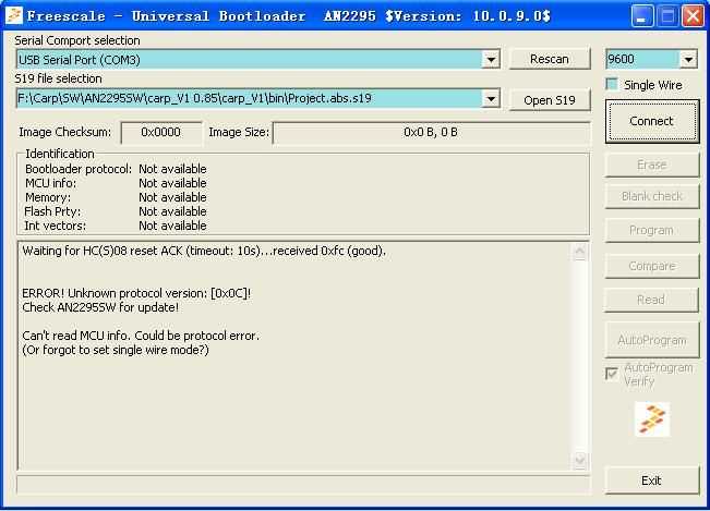

hello, everybody,  I met a puzzle problem when I used AN2295sw in MC9S08LH36 microcontroller. According the application manual, first I download the S19 file of S08LH project in src folder, then I use win_hc08sprg.exe to open my program's S19 file in PC, when I click the connect, it hints error, unknown protocol version.

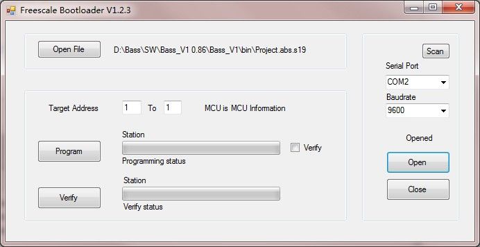

Monica, I didn't try to Samuel's suggestion, but I get the another solution from Freescale engineer. this solution includes a PC software and a bootloader file, I need add this bootloader file into my work and modify initial program in order to enter bootloader status. Finally, this solution can work. the following picture is PC software interface.

sachin_k
Hi Daniel,
I am getting the same error .Can you please share Freescale Bootloader V1.2.3.exe file with me.

danielhou

the detailed error information is shown as following, and I also try to download the merging S19 file from my program and S08LH, but it failed, please help me, thank you!

rabbit
Hi Daniel,
I get similar problem for K60 MCU. You need download the AN2295 firmware to your target MCU, then it can talk to the bootloader.
Good luck.
