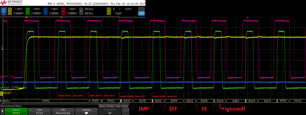

As an aside, putting a JMP $FFFE is incorrect as $FFFE does not (should not) contain an opcode but the address to one.  The correct sequence to go where the reset vector points is LDX $FFFE followed by JMP ,x
Regardless though, based on the fact that the sequence continues to E003, it shows that most likely your CONFIG register has been set to enable internal ROM, and your external memory changes are completely ignored.  It seems that some internal application (or garbage) is running.
BTW, you don't need any special equipment to deal with the CONFIG register.  Simply put the board into Special Test Mode via MODA/MODB pins, and use some free app like JBug11 (for Windows) to read and possibly re-program the CONFIG register.  If your CONFIG value is inside your S19 file, simply program it over whatever value is there, and try again to see if it works.  (My guess is it will.)
Note: You do not need to put the board into Special Test Mode to program CONFIG, only to read it.

davidatkins1
You were absolutely correct, Tony – the CONFIG register was corrupt! The processors what were ignoring the reset vector had the ROMON and EEON bits both incorrectly set but I also found some boards that were stuck in a reset loop and those had the NOCOP bit incorrectly cleared, enabling the watchdog timer.
Do you have any idea how this corruption could occur? The software guys tell me they don’t touch the CONFIG register or the BPROT register that protects it. I guess it’s feasible that the chips we’re buying have this register set incorrectly at the factory. Has this sort of thing occurred before?

Hi again Tony,
Thanks for getting back to me. To answer your questions:
I guess it’s possible that the CONFIG register is programmed incorrectly on the bad processors. Unfortunately, this is an old product and we don’t have a development system anymore so I can’t easily read the contents of this register.
The vectors for the COP, clock monitor, interrupts, timers, overflow etc are all initialised & correct and none point to $E000.
The jump to $E000 occurs immediately after the reset vector to $FECD is received (see attached plot).
We’ve tried a faulty processor in two different products and it doesn’t work in either of those. This is not completely conclusive as the original product and these other two share similar hardware and software designs. I’m trying to locate an official Motorola/Freescale evaluation board to try the processor in there, but this may take a while.
I’ve manually edited the hex file to add an extended-mode JMP $FFFE instruction to location $E000 and the processor doesn't seem to respond to it at all – see attached scope shot. It shows (from left to right)…
- Reset rising after power-up (yellow trace)
- The processor puts out the reset vector of $FFFE, PROM responds with $FE
- The processor puts out the reset vector of $FFFF, PROM responds with $CD
- The processor jumps to $E000 where it finds the JMP $FFFE instruction ($7E, $FF, $FE)
- The processor continues to addresses $E003 and $E004, completely ignoring the JMP.
- The program counter then inexplicably goes to $FFFF!
BUS1 consists of the upper half of the address bus in the high-order byte and multiplexed address  & data bus in the lower byte.
