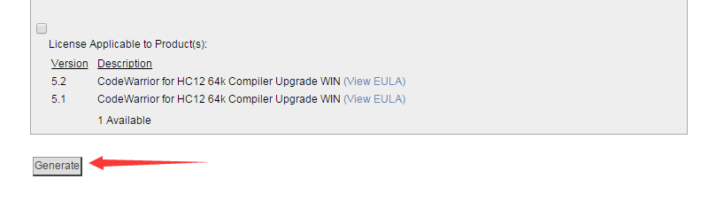

2、首先在官网上面先生成lincese.dat文件,生成方法我是参考文档《Software and Support Activation Quick Start Guide》,具体步骤如下:
单击generate,生成lincese

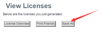

单击save all,保存生成的lincese.dat文件

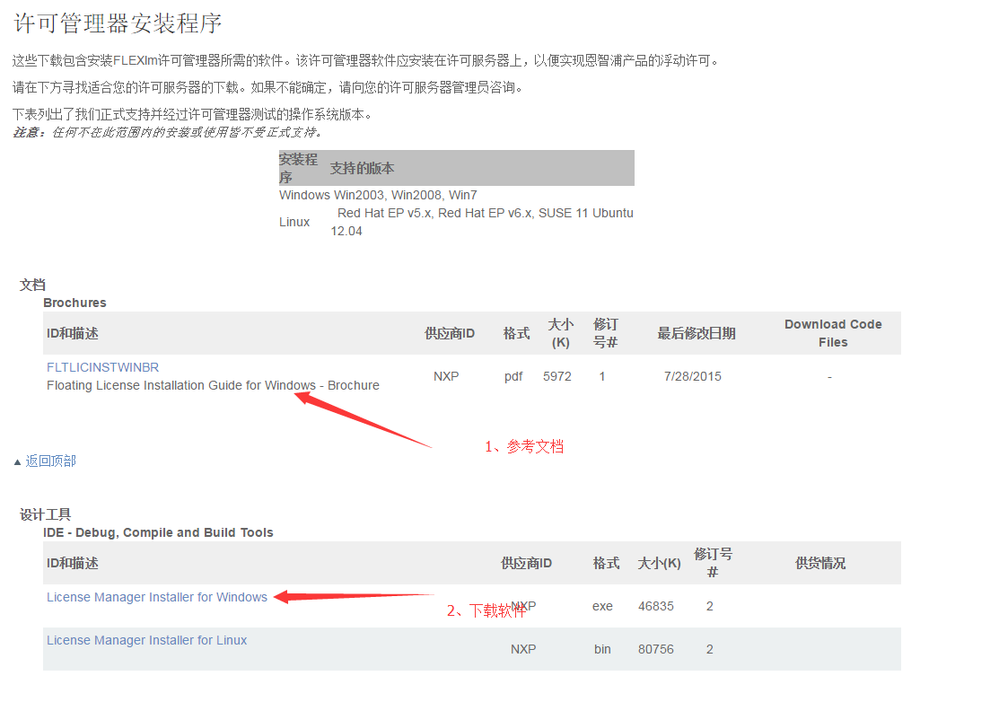

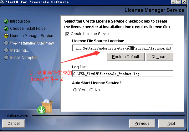

3、安装FSLFlexLMinstall管理程序,我参考的文档是《Floating License Installation Guide for Windows》,具体步骤如下:
进入许可管理器的网站
我所使用的服务器版本,
服务器上准备好安装必须文件,
开始安装许可管理程序

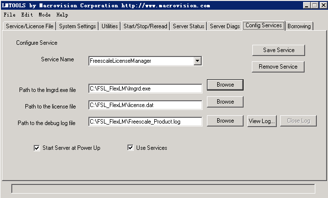

安装完成之后,运行
单击start server

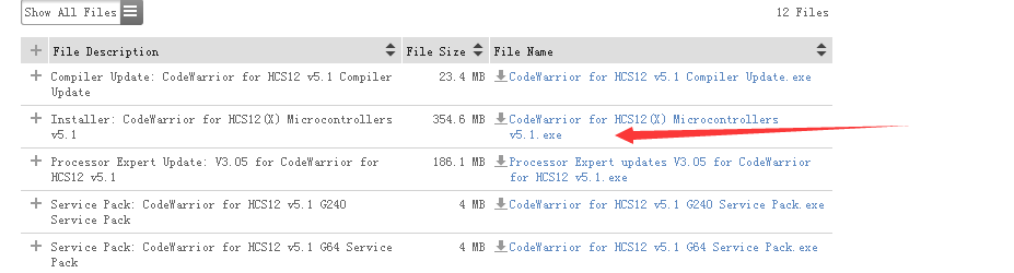

客户机上安装CW_S12_V5.1,下载安装包文件
下载完成后,开始安装,安装完成之后,IDE打开,显示没有注册,

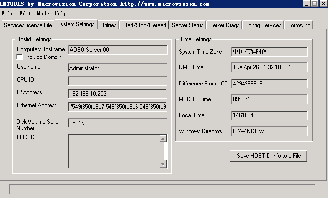

同时在服务器上面

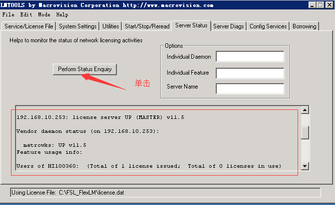

红色框图显示的完整信息如下
Status
Flexible License Manager status on Tue 4/26/2016 09:33
[Detecting lmgrd processes...]
License server status: 27000@192.168.10.253
    License file(s) on 192.168.10.253: C:\FSL_FlexLM\license.dat:
192.168.10.253: license server UP (MASTER) v11.5
Vendor daemon status (on 192.168.10.253):
  metrowks: UP v11.5
Feature usage info:
Users of HI100360:  (Total of 1 license issued;  Total of 0 licenses in use)
Users of HI407284:  (Total of 1 license issued;  Total of 0 licenses in use)
Users of HI100300:  (Total of 1 license issued;  Total of 0 licenses in use)
Users of ProcessorExpertHCS12:  (Error: 1 licenses, unsupported by licensed server)
Users of Win32_CWIDE_Unlimited:  (Error: 1 licenses, unsupported by licensed server)
Users of HI100350:  (Total of 1 license issued;  Total of 0 licenses in use)
问题:为什么客户机上IDE没有注册?

Hello gao
First, please place the license file under CodeWarrior installation folder, usually is: C:\Program Files\Freescale\CWS12v5.1
Then, please check the hard disk ID of your server,  to get it, please:
  1.       Open a DOS prompt
  2.       Type ‘cd C:’ (return
  3.       Type ’VOL’ (return)
  4.       Copy the Volume Serial Number value without the dash
For how to install Floating license, please refer to this doc:
http://www.freescale.com/files/soft_dev_tools/doc/user_guide/CW_FLOA_LICEN_UG.pdf
