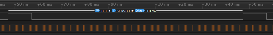

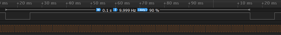

PWM 500Hz, 90%:
PWM 500Hz, 10%:
PWM 10Hz, 90%:
PWM 10Hz, 10%:
The lower signal is the output of the timer in 16-bit counter mode.
Please try the code.
