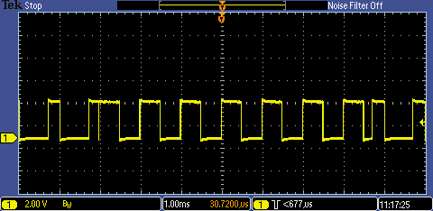

I'm using PWM on the i.MX53 as an LCD Backlight Driver control.
When the brightness is ramped up it all works fine. When it is ramped down there are glitches.
That happens a lot on old and cheap PWM timers. What it means is that the Comparison Count register was reloaded just as the counter was approaching the previous value in that register and about to get a match. But the reload jumped the comparison value "back over" the counter, and so it ran to the end of the cycle without getting a match and without turning the output off. Hence you get one full cycle at 100%, causing a one-cycle "glitch".
Better PWM controllers keep a copy of the Sample/Comparison value, and only replace it at the end of a cycle so there are no glitches. With cheaper controllers you have to write code to take an interrupt at the end of a cycle and load the new value then. This goes badly wrong at low duty-cycles when the PWM counter beats the interrupt routine, or the interrupt gets delayed.

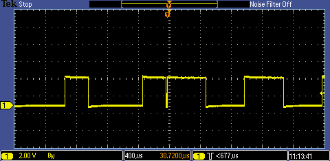

Here's an example of the glitch happening on a controller that doesn't buffer the sample value. The Yellow line is a falling ramp value which is the brightness of the screen. The Pink is the PWM output. You can see one full-length cycle when it missed the comparison.
Except that's the PWM controller in the i.MX53. It has a four-deep FIFO that is MEANT to stop this from happening. Except the Data Sheet is contradictory on how it works.
This bit implies "there's a FIFO and it works like you'd expect so as to prevent glitches":

From the flashing on my screen and the oscilloscope trace above it looks like it doesn't work properly. If the FIFO is empty it takes the new value immediately. It only seems to buffer the sample when the FIFO is "loaded". That may be the case when sending a continuous waveform (music) through the PWM, but not when changing it intermittently when controlling a backlight.
I have found a work-around that proves my assertion.
If I read the FIFO then write the same value back (to load a value) and THEN load a new value in, it doesn't flash any more. Having the second value in the FIFO makes it wait until the end of the cycle. Of course the driver could keep a copy of the previous value and always write previous/next on an update.
That looks like a silicon bug to me. I've checked the i.MX53 and i.MX6 Errata and the PWM isn't listed. At the very least the chip isn't doing what the first quote from the manual above states.
Edit: I've just found the following Forum post which shows the same problem on the i.MX6"
PWM glitches on iMX6
There are two fixes listed there. First invert the PWM signal so it glitches DOWN instead of glitching UP (but it still glitches). Secondly, setting the REPEAT bits seems to fix this as well.
Setting the REPEAT bits was asserted to fix the problem. I've tested this. It doesn't.
The "test code" is as simple as:
root@triton1:/sys/class/backlight/pwm-backlight.15# while true; do echo 50 > brightness; sleep 0.1; echo 90 > brightness; sleep 0.1; done
root@triton1:/sys/class/backlight/pwm-backlight.15# while true; do echo 50 > brightness; sleep 0.01; echo 90 > brightness; sleep 0.01; done
I have inverted dimming, so "90" is "10%" and the above switches between 10% and 50%. Here's what that looks like with the glitches going to 100% "occasionally", about every second try!
Here's the change to "arch/arm/plat-mxc/pwm.c" to add the Repeat Count:
#define MX3_PWMCR_CLKSRC_IPG      (1 << 16) #define MX3_PWMCR_REPEAT_1        (0 << 1) #define MX3_PWMCR_REPEAT_2        (1 << 1) #define MX3_PWMCR_REPEAT_4        (2 << 1) #define MX3_PWMCR_REPEAT_8        (3 << 1) #define MX3_PWMCR_EN          (1 << 0) ...
        cr = MX3_PWMCR_PRESCALER(prescale) |             MX3_PWMCR_DOZEEN | MX3_PWMCR_WAITEN |             MX3_PWMCR_DBGEN | MX3_PWMCR_EN |             MX3_PWMCR_REPEAT_4;
Here it is with "REPEAT_2", still showing glitches:
With "REPEAT_*" and with the test code cycling slower at 0.1 second to allow the repeats to "drain". The trace is zoomed in on a glitch.
Here's a trace where I'm writing the old-then-new values into PWMSAR on each update. There are no glitches.
This is the only fix I know of for this problem.
The same PWM controller is also in at least the i.MX51. i.MX31 and i.MX27, but not the i.MX28.
Tom
