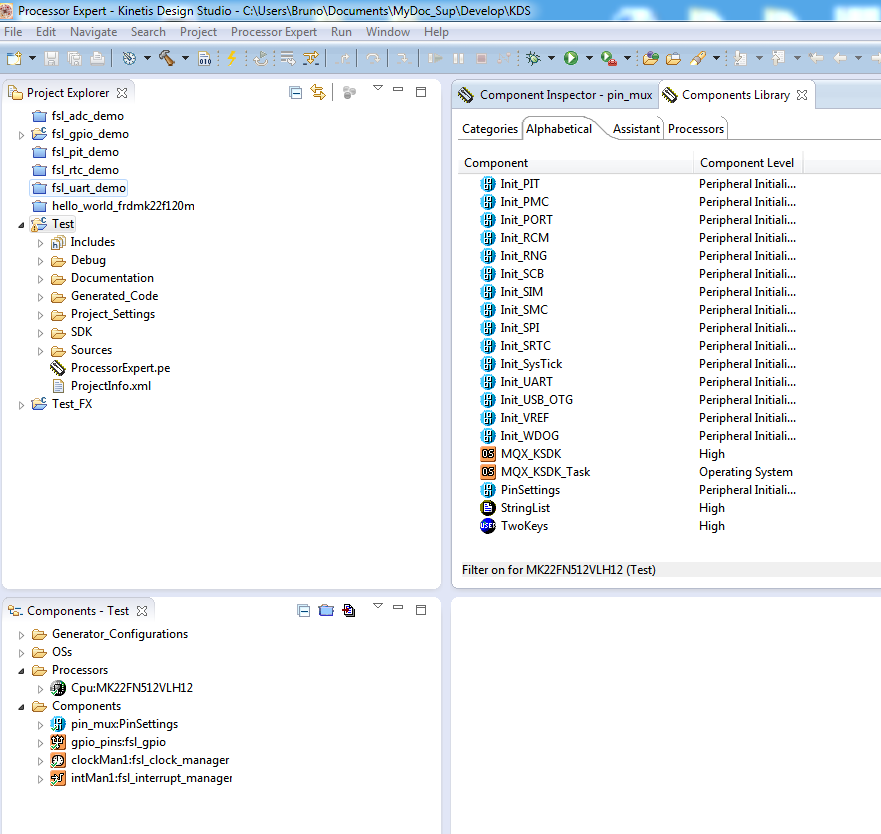

I am having trouble understanding what options of MQX are available for each platform in KDS:
-     When I create a new project for an MK21FN1M0xx12 processor, I have a choice of MQX or MQX-Lite
-     When I create a new project for an MK22F512xxx12 processor, I only have a choice of MQX_KSDK (Not MQX-Lite)
It is not easy making sense of this, the two platforms are very-very (-very) close, and if anything the MK22F512xxx12 has less resources and could benefit from having the lite (static) version of MQX.

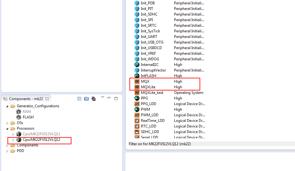

Hi Bruno,
MQX and MQX_Lite will be all exist , and MQX_Lite is fundamental and simple .
And in the future , all the kinetis series platforms  can develop on KDS .
I check the MK22F512xxx12 on KDS , and it have the  MQX and MQX_Lite ,
Alice

brunopaillard
Hi Alice
The "FX" does, but NOT the FN...!
See below:
Am I missing something?
Bruno

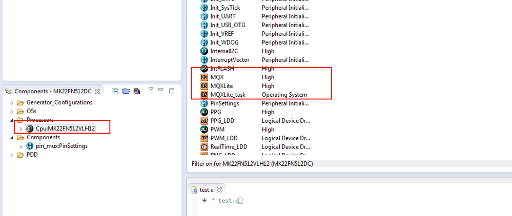

brunopaillard
Hi Alice
I installed the service pack as you indicated, but I cannot see the MQX_Lite version when I select the MK22FN512VLH12 CPU. I can only see it when I select a MK21 CPU.
Interestingly, I can also not see the USB_LDD driver with the MK22FN512VLH12 CPU.
I know that these options are installed in KDS (otherwise they would not appear with any processor).
Is there something that I am missing?
You seem to have them available in your setup. How did you install?
Bruno

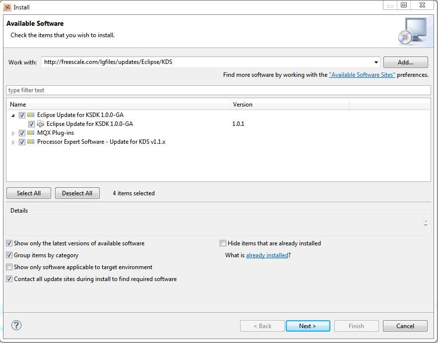

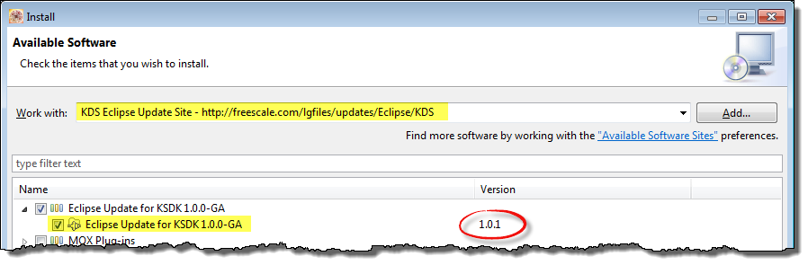

brunopaillard
Hi Jorge
I looked at the site you mentioned. It seems that Eclipse update for KSDK was already at V1.0.1 (see image below)

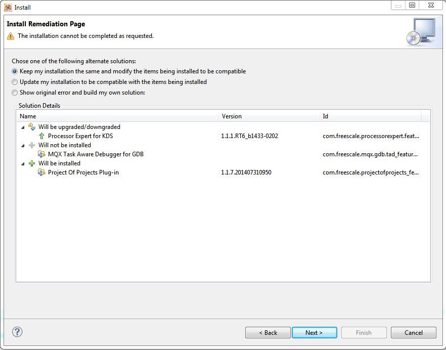

I saw that there were two other updates that could be installed. But when I attempted to do that, here is the response that I got:
There seems to be some inconsistency in the versions of the various components... What should I do? install the updates, or not...?
What radio button should be selected?
Another question/comment:
The update process is VERY nebulous and leaves me with many more questions than answers:
-     It is not at all clear which updates should be found locally (in an archive), and which should be found on the web
-     What sites should be consulted to get the latest updates (there are more than 10 possible ones indicated... possibly some NOT indicated?)
-     Same thing with the updates that are contained in .zip files (where to find them in the installation directories? How can I know which is current, which is not?)
-     In the past I found some updates in archives, but either the update tool would not install them (just saying for a while it was trying to find an alternative solution), or would install them if I downgraded some component... Not clear what to do then!
It would be EXTREMELY useful to have a simple procedure to follow to make sure one has all the latest updates and plug-ins/modules. Right now I must admit that I am very lost
Bruno
