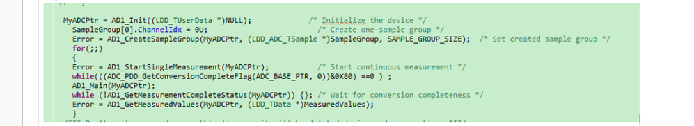

    So I check the ADC register,  after I run this code:
   Error = AD1_StartSingleMeasurement(MyADCPtr);
  I find the ADC_SC1[COCO] already be 1, it means, the ADC already complete once converstion.
  But when run
     while (!AD1_GetMeasurementCompleteStatus(MyADCPtr));
  The Status = DeviceDataPrv->CompleteStatus; in AD1_GetMeasurementCompleteStatus(MyADCPtr) function didn't get 1.
  The problem is the real register of ADC didn't updated to DeviceDataPrv->CompleteStatus.
   Then I modify the code in the main function to update the code to DeviceDataPrv->CompleteStatus and DeviceDataPrv->IntBuffer[Sample], the code will run OK, and the ADC result is correct.
  My code in main function is as follows:
I also attached my project, you can refer to it.
Wish it helps you!

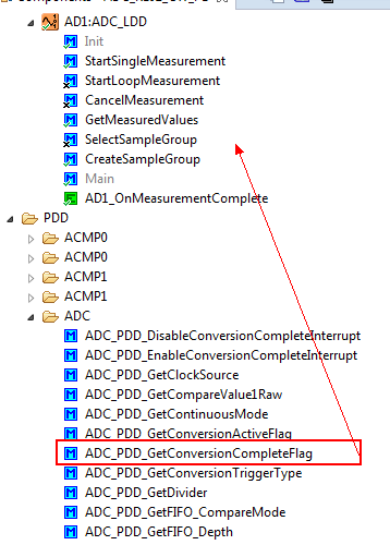

I find the function of  "ADC_PDD_GetConversionCompleteFlag()" on  PDD->ADC,  while how put it in ADC:ADC_LDD,  and in the methods i couldn't find it.
And how i find the code about this function ?
Thanks!

2,130 Views
Fan_xy
Hi,JingJing
I could find the function,  I mean that  can I  put "ADC_PDD_GetConversionCompleteFlag"  to the components->AD1.like the screenshot
Thank you !
Linda

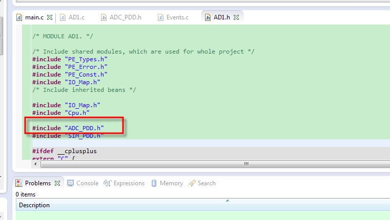

2,130 Views
kerryzhou
Hi Linda,
    No, you can't  put "ADC_PDD_GetConversionCompleteFlag"  to the components->AD1 directly, and you don't need to put it into the ADC_LDD module.
Because in the AD1.h, it will include the ADC_PDD.h directly.
WIsh it helps you!
