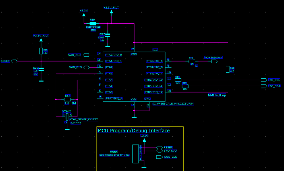

Hello All,
Can I program and debug KL02 series MCUs (MKL02Z8VFG4) with  FRDM-KL25Z?  If not, What is the difference, SWD Protocol, OpenSDA?
Would FRDM-KL02Z a proper candidate for this job?
Thanks in advance
Best Regards

gokhanozcan
Hi Kan,
No, I have a custom designed board which has a MKL02Z8VFG4 on it. I want(ed) to debug and program it with FRDM-KL25Z. I just want to verify if this is possible, and what is the reason behind it? It would help me make some future decisions accordingly.
Thanks.

gokhanozcan
Hi Erich,
I have done everything necessary to get it running with USBDM. J11 disconnection, USBDM and drivers etc.
Firmware is c:\Program Files (x86)\pgo\USBDM 4.10.6.190\FlashImages\MKxx\OpenSDAv1.sx
I can program (ARM Programmer -USBDM) and debug with CW10.6 the development environment's on board target MCU MK25Z128VLK4.
I can program and verify my custom board with MKL02Z8VFG4 too.  But I can't get it running. Also I can't debug with CW10.6 this board. It is saying "Failed to resume target process. Downloading binary to target"
As far as my hardware concerned:
I have checked my cable. my connection is as below. I have removed the  XTAL2 8MHz  crystal resonator which was out-of-spec. Try to run it with the internal oscillator.  My cable connection is
FRDM-KL25Z--------------- My Application
J6 ------------------------------ CON5
1 ---------- 3.3V ------------- 3
2 -------SWD_DIO---------- 2
3 -------GND------------------ 5
4 -------SWD_CLK--------- 4
10 ----- RST ---------------- 1
am I missing something?

BlackNight
Can you use either a P&E Multilink or Segger J-Link with your custom board? There could be many things going wrong with you setup, starting with having the wrong CPU specified in the debugger settings. It seems like your debug connection is somehow not able to get control over the target. That might be an electrical issue (noise? bad traces?). I have seen similar problems with my own custom boards, and using a Multilink of J-Link helped me to reduce the number of variables in the equation.
I hope this helps,
Erich

gokhanozcan
I have replaced MCU with MKL02Z32VFG4. Now everything works fluent. Though I am having hard time to understand what was wrong.
I have checked the binary footprint it was 6KB which is OK to fit in 8KB of former MCU. Application is a blinking LED example produced with Processor Expert like in  Tutorial: Enlightning the Freedom KL25Z Board | MCU on Eclipse
