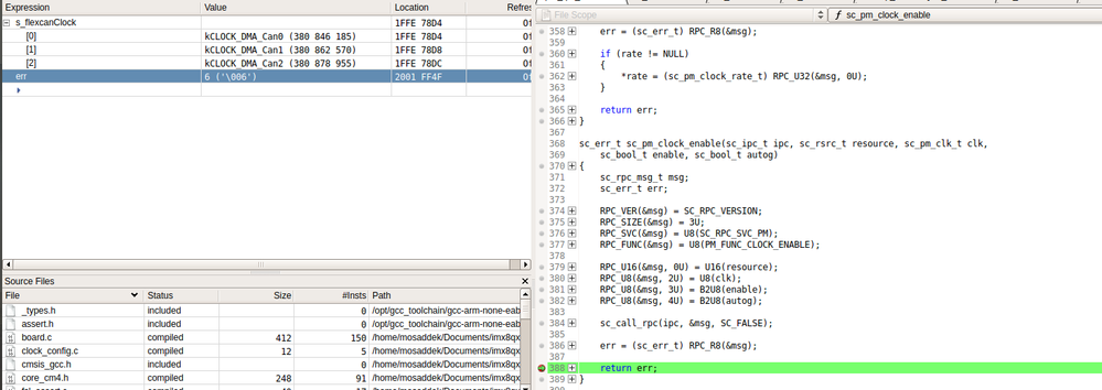

Hallo NXP Community,
I have successfully configured FlexCAN0 in M4, and it is working perfectly.
The problem occurs when I want to configure FlexCAN1.
In the Reference manual for CAN0 , CAN1 and CAN2, they all use the same clock gate.
Each CAN module is assigned to different LPCG_REGS. The driver code from Imx8qxp SDK CM4, As shown below:
kCLOCK_DMA_Can0 = LPCG_TUPLE(SC_R_CAN_0, ADMA__LPCG_CAN0_IPG_CLK_BASE),
kCLOCK_DMA_Can1 = LPCG_TUPLE(SC_R_CAN_1, ADMA__LPCG_CAN1_IPG_CLK_BASE),
kCLOCK_DMA_Can2 = LPCG_TUPLE(SC_R_CAN_2, ADMA__LPCG_CAN2_IPG_CLK_BASE),

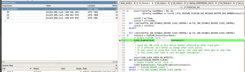

The Function in M4 try to enable the clock in CM4 for FlexCAN1 using kCLOCK_DMA_Can1
/* Enable FlexCAN clock. */
CLOCK_EnableClock(s_flexcanClock[instance]);
Then the Function Below try to verify the kCLOCK_DMA_Can1 resource with SCFW
  • brief Enable the clock for specific IP, with gate setting.
  • param name Which clock to enable, see \ref clock_ip_name_t.
  • param gate 0: clock always on, 1: HW auto clock gating.
  • return true if success, false if failure.
err = sc_pm_clock_enable(ipcHandle, LPCG_TUPLE_RSRC(name), SC_PM_CLK_PER, true, (bool)gate);
Then it returns an error message: -->SC_ERR_UNAVAILABLE 6U /!< Unavailable (out of resources) /
This means the m4 tries to communicate with SCFW for VALID resouce or dma_clock for CAN1, and this instance is missing in SCFW.

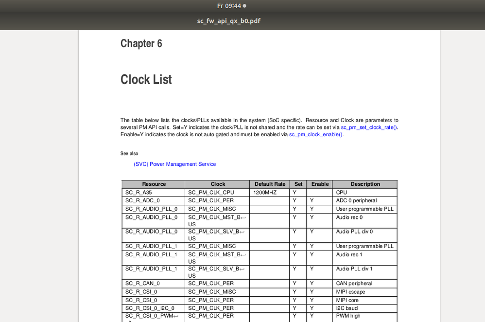

The reason for this failure is when CAN1 is enabled it tries to enable the clock gate with kCLOCK_DMA_Can1 . This is not being implemented in SCFW.
--First I configured CAN0 ,
After that CAN1 ,
Then again CAN1 has the same error.
Is there any valid solution for CAN0 and CAN1 in M4 to run parallely?

The flexcan on 8QX is implemented as below :
  • Power domain of CAN1/CAN2 is the child domain of CAN0's
  • FlexCAN0,CAN1/CAN2 share the clock root, SCFW provides CAN0 clock control list(interface) only to enable or disable the clock.
So
  • when use CAN1/CAN2 you need to power on CAN0 as well, take CAN1 for exampe :
    if (sc_pm_set_resource_power_mode(ipc, SC_R_CAN_0, SC_PM_PW_MODE_ON) != SC_ERR_NONE)
        PRINTF("Error: Failed to power on FLEXCAN0\r\n");
        if (sc_pm_set_resource_power_mode(ipc, SC_R_CAN_1, SC_PM_PW_MODE_ON) != SC_ERR_NONE)
        PRINTF("Error: Failed to power on FLEXCAN1\r\n");
  • Flexcan clock table should all set to CAN0 in fsl_clock.h as below , as scfw only provides control interface for CAN0, the new package for 8QX will be available soon with the patch.
#define FLEXCAN_CLOCKS                                     \
        kCLOCK_DMA_Can0, kCLOCK_DMA_Can0, kCLOCK_DMA_Can0, \
Please have a try.
