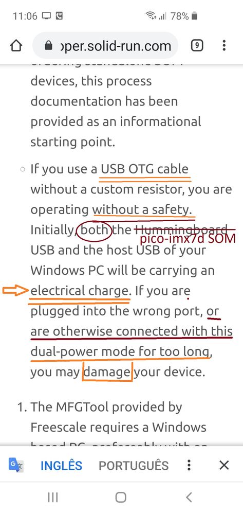

I have this issue: My other imx7d pico android things start kit died, again
I was following the steps of this link: iMX7D Pico won't boot
I used the <LIST name = "eMMC-Brillo-uboot" script from ucl2.xml file
I left the script running beyond time. After Done appeared on the screen it was still running for about 8 minutes.
I think I found out what burned my devices. And the answer is in the link/iIMAGE below (despite being another SOM)
https://developer.solid-run.com/knowledge-base/efuses-for-imx6-som/.
My questions is:  What component did it damage? How to make sure which component(s) burned? Why it spoiled?

I’m afraid that the i.MX7D Pico board is manufactured and supported by TechNexion so I would recommend that you contact them especially if you are facing hardware issues.
