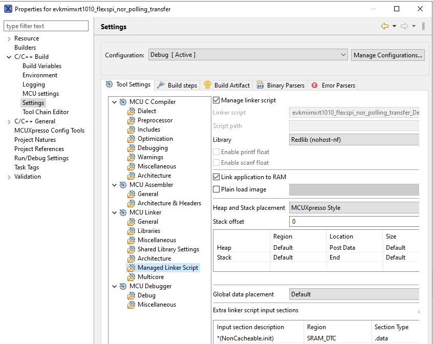

In my case, I am working with i.MX RT1010, I build the custom board with same MCU and SPI Flash IC on the MIMXRT1010 EVK.
I was not able to write the code into Flash IC because of the QE bit, so I enabled it with your suggested code as below. I also have to run it from RAM by tick on "Link Application to Ram"
Now I can download the code into Flash with MCU Falsh tool. The code runs, (LED is blinking) but somehow I can get it run in debug mode. MCUXpresso shows msg:
Break at address "0x20ea90" with no debug information available, or outside of program code.
Do you have any idea? Feel free to help
Thank you.

Yuri
  Please check Your QSPI image, if it is correctly prepared, as described
in app note AN12108 (How to Enable Boot from QSPI Flash, Rev. 3, 09/2018)
https://www.nxp.com/docs/en/application-note/AN12108.pdf
  Also, app note AN12183 (How to Enable Debugging for FLEXSPI NOR
Flash) may be useful.
https://www.nxp.com/docs/en/nxp/application-notes/AN12183.pdf
