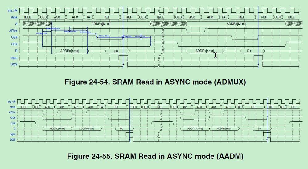

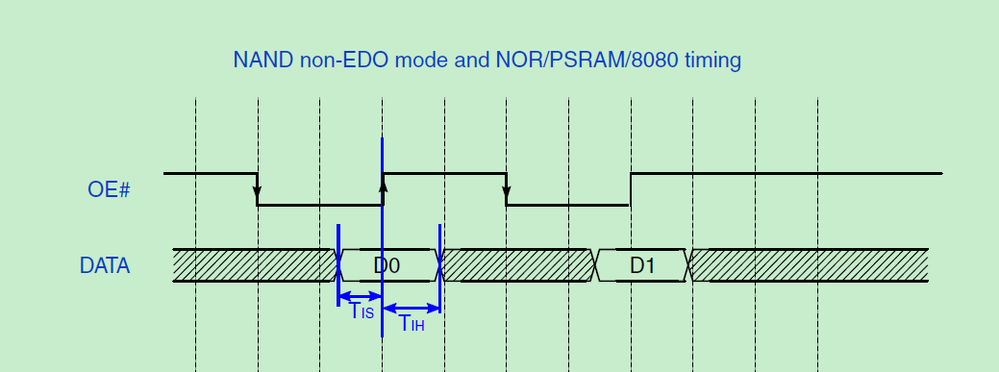

Please check below timing when SEMC SRAM mode:
What's the Enable status?
If low voltage is latch enable, from SRAM read timing, if #OE is low voltage, whatever A16 voltage level, the D1 status will be latched. It need to make sure D1 signal doesn't change voltage level at latch sampling phase.
What's the latch1 sampling time? If at #OE falling edge, that could cause problem.
From RT1050 datasheet, The sampling time should at rising edge.
Please check the Latch logic to meet the SEMC SRAM timing.
Wish it helps.
best regards,
Mike

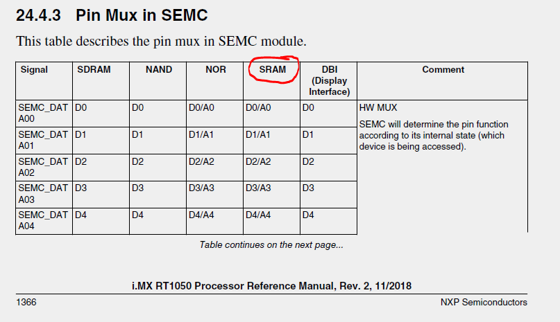

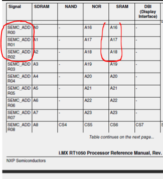

According to the SEMC Pin Mux when SRAM is initialized:
SEMC_ADDR[0] = A16
SEMC_ADDR[1] = A17
SEMC_ADDR[2] = A18
SEMC_ADDR[12] = OE#
In code, how can I set SEMC_ADDR[0] and SEMC_ADDR[12] low and SEMC_ADDR[1] and SEMC_ADDR[2] high?

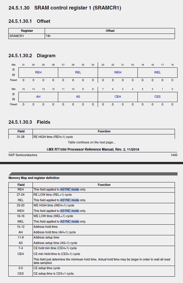

Please help to provide SEMC SRAM control register [0~3] values.
Please check the SRAM control register 0 (SRAMCR0) [AM] bits should be 0b1x (non-MUX mode) and [BL] bits be 0b000.
Wish it  helps.

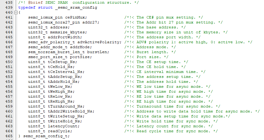

Customer could refer SEMC SDRAM demo and try to Initialize SEMC for SRAM.
Customer could call SEMC_ConfigureSRAM() SDK driver to config SEMC for SRAM.
After SEMC configured for SRAM, when access SRAM related address range, related pins will be drive.

I understand that I need to configure the SRAM using SEMC_ConfigureSRAM() SDK driver, which I have already done. My issue is with memory mapping.
I want to use 0xA0010000 for to enable latch1 by setting SEMC_ADDR[0] low with SEMC_ADDR[1] and SEMC_ADDR[2] set as high. Therefore, when I call "0xA0010000 & bit1" I will be able to read in only bit1 from latch1 while latch2 and latch3 are disabled.
I don't know how to do this in code, not sure what syntax is used for this type of memory mapping.

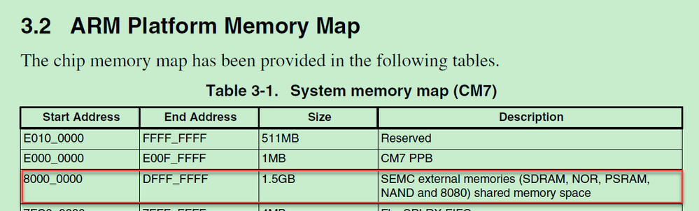

RT1050 reference manual SEMC module mentioned "SRAM" is another type memory device, such as MRAM or PSRAM.
I could use MR2A16ACYS35 as an example.
The MRAM device using the different hardware connection with SEMC, compared with SDRAM memory.
The SEMC using address and data multiplex mode, the low 16-bit address share the same pin with 16-bit data.
There required external address latch chip with external SRAM connection.
The memory range 0xA0000000 is opened to external SRAM device, which could be get from below table:
Wish it helps.

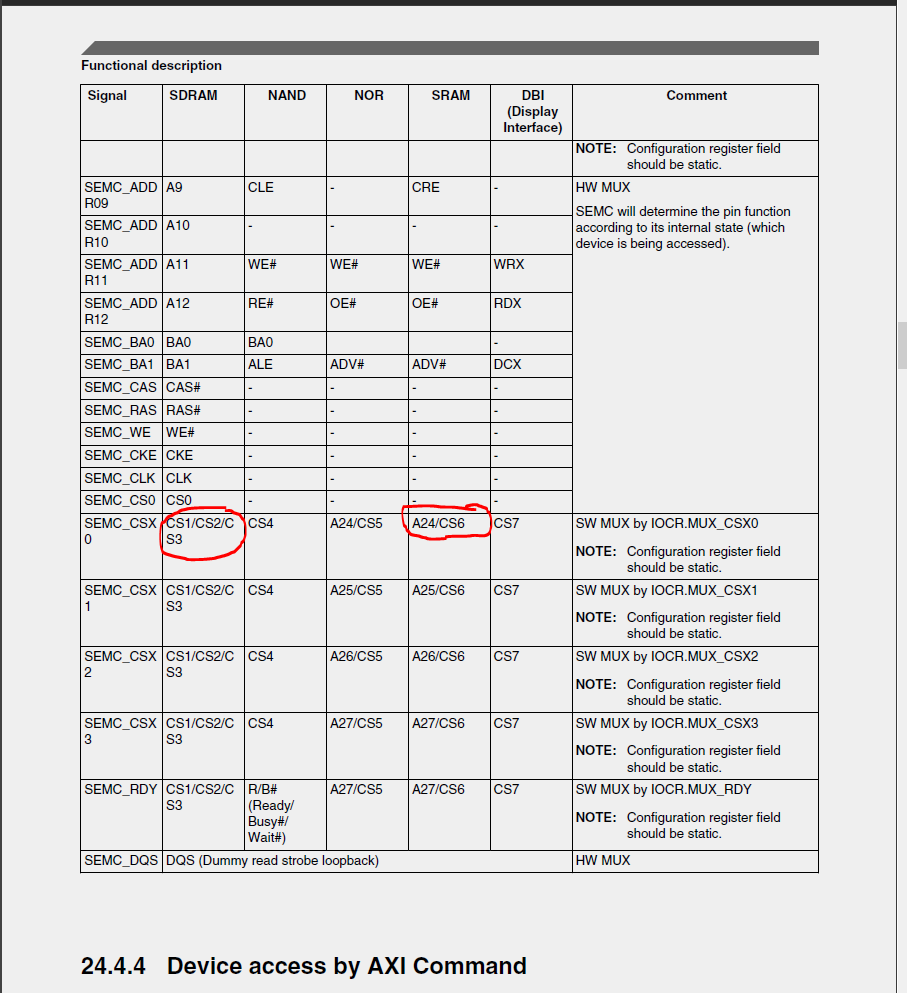

So your saying that the SEMC can support SRAM at 0xA0000000 but there is none on the board. I have to add external SRAM then configure it with SEMC, correct?
If I currently do not have external SRAM and have some hardware connected to latches controlled by the SRAM Pinmux pin such as CS6, can I just set the SEMC configured with SDRAM at 0xA0000000 and using the corresponding SDRAM pin to enable the latch?
Is it possible to use the SEMC SRAM region (0xA0000000) as I/O pins instead of memory? This way I can have 3 latches and pick from them using a memory range. I am using the SEMC as if I have an external SRAM but I don't, I just want to use that memory range for my latches.
To reword the question using the screenshot, can I use CS1/CS2/CS3 (SDRAM) instead of A24/CS6 (SRAM) to enable my latch? Also, is it possible to manually set the gpio_emc_xx pins as high or low? Right now my hardware is connected to latched which are enabled using CS6 from the SEMC SRAM so I want to use the SDRAM instead.
7,264 Views
Hui_Ma

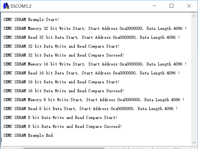

Mike:  Yes, your understanding is correct.
I did a test to config IMXRT1050-EVKB on board SDRAM memory at 0xA0000000, which works.
I use SDK software package provided [semc] demo, just change below codes at <semc_sdram.c>file:
Line 18   #define EXAMPLE_SEMC_START_ADDRESS (0xA0000000U)//(0x80000000U)
Line 58             sdramconfig.address             = 0xA0000000;//0x80000000;
After that, the SDRAM could be access with start address at 0xA0000000.
About SDRAM related pins latch, I think it works.

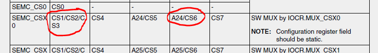

Will I need to change the signals to match the SDRAM instead or can I use the corresponding signals from the SDRAM?
For example, instead of using the CS6 signal for SEMC_CSX0, can I use the SDRAM signal CS1/CS2/CS3?
