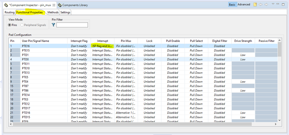

If you want to independently detect in your application the edges of CS you can connect another GPIO configured as input to CS. That pin should be configured to trigger interrupt request.
If you are using SDK and ProcessorExpert you should configure your GPIO like in this picture:
To install the interrupt request you must call these 2 functions in your application: INT_SYS_InstallHandler();INT_SYS_EnableIRQ();

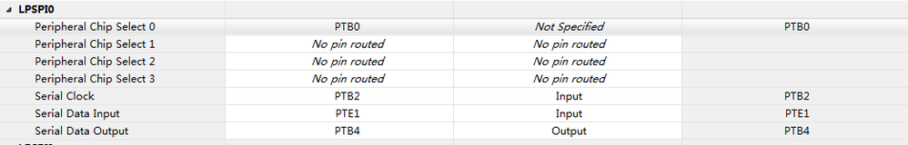

- 1     I am now doing the following configuration for SPI slave

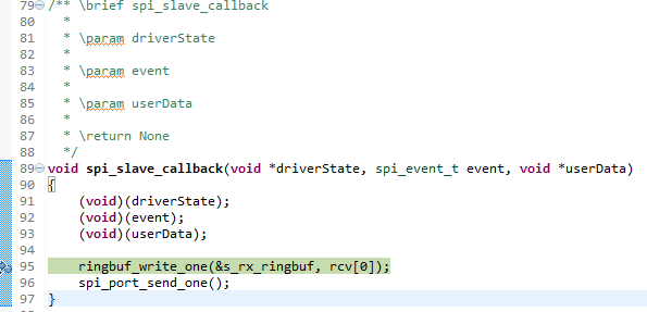

I use the following spi slave send interface to send a single byte
 LPSPI_DRV_SlaveTransfer(USE_SPI_INSATNCE,(const uint8  *)&send,(uint8 *)&rcv,(uint16)1);
When my spi master sends a byte of data, the slave can enter the interrupt, as shown below

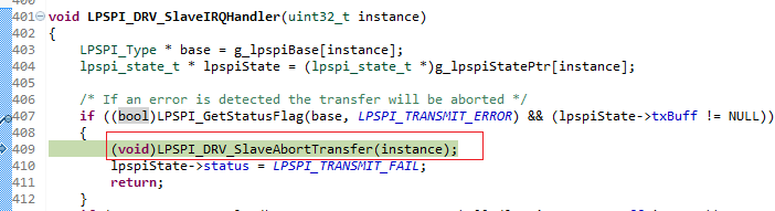

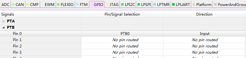

- 2   When the chip select is configured as a normal GPIO port
When my spi master sends a byte of data, the slave can enter the interrupt transmit error, as shown below
So I have doubts, can the spi slave CS select pin can be used as normal GPIO for rising edge and falling edge detection, reading SPI slave data?

The right approach to make LPSPI to work fine is the first one. I have only one suggestion: please set the direction as input for PTB0.

I have solved this way. First, PB0 is configured as the CS pin of the hardware, and then when the software is initialized, it is configured as a bilateral edge trigger.
