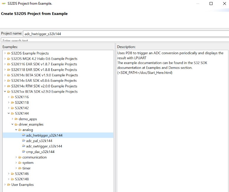

There is an SDK example that shows how to trigger ADC with PDB.
