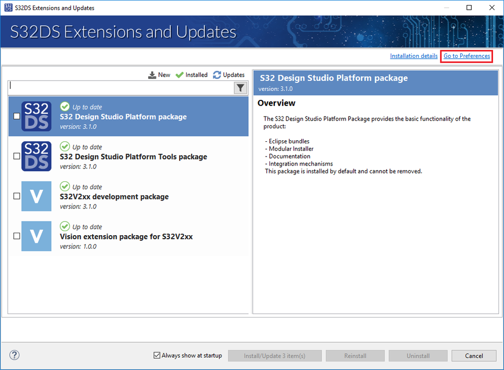

    • Start S32 Design Studio and go to "Help" -> "S32DS Extensions and Updates"pastedImage_12.png

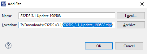

    • Add a new "Add.." S32DS Software Site and browse to select the downloaded update archive .zip file you downloaded in the previous steppastedImage_6.png        pastedImage_2.png
