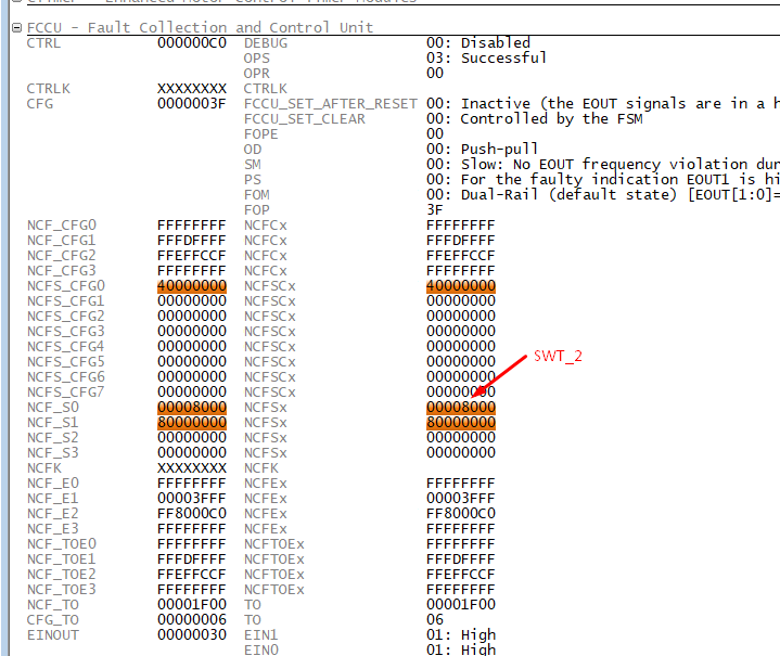

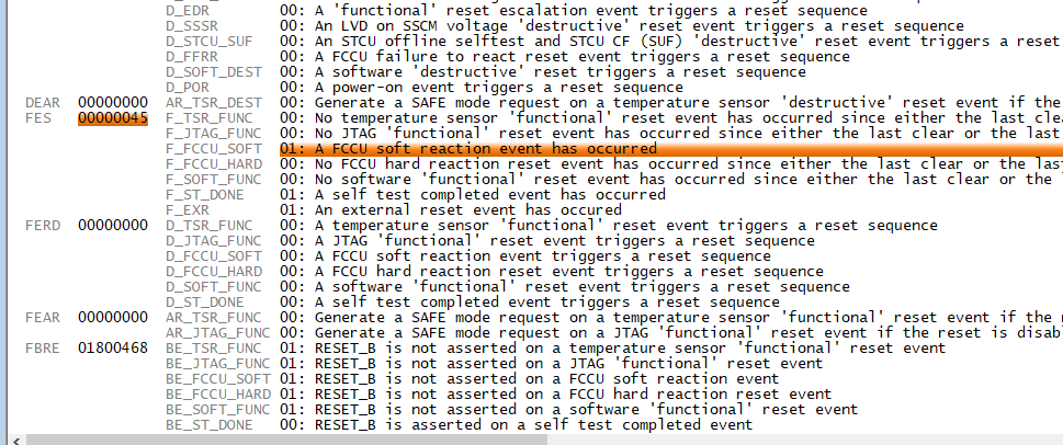

This example demonstrated the reset trigger on first SWT_2 timeout.
Following screens shows the reset source after code execution in standalone mode and debugger connection afterwards:
Comments
Hi Peter,
I am working on S32R274 and I need help for SWT_2.
I need your help regarding above code :
I am not able to see the NCFS_CFG0 is getting updated with my value 0x40000000 .
FCCU.NCFS_CFG[0].R = 0x40000000;.
and I can see that, NCF_S0  is showing value 0x00070000.
Below are the screen shot during debug :
Could please help me,. why this value NCF_S0 = 0x00070000, as I have just configure SWT_2 only.
and why I am not able to see the my written value in NCFS_CFG0.
Thanks !
