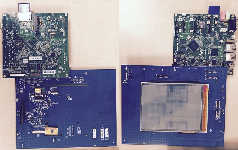

Hardware connection:
there are two board-to-board connectors on E-INK daughter card IMXEBOOKDC4, while there is only one on i.MX7D Sabre board, as the picture below. This might be a bit confusing to connect the two:
Checked with internal, the original design was trying to wire both eLCDIF and EPDC bus out to one daughter card, add the flexibility to have different configurations on one display daughter card(LCD/EPD). On i.MX7D Sabre board, only one connector is available for EPDC bus.
Here is how we connect i.MX7D Sabre and IMXEBOOKDC4:

Hi!
We've followed the instructions provided here to the letter, but the contents on the display are corrupted: IMG_20160523_105613.jpg
We've tried running all of the three different unit tests; mxc_epdc_fb_test.out, mxc_epdc_v2_fb_test.out and mxc_epdc_x11_fb_test.out. For the two first ones we have tried both with and without killing the X11 session. We have rebooted inbetween running each of the unit tests. All of them display similar corrupted output.
The md5sum of the fsl-image-gui-x11-imx7dsabresd.sdcard image we have is ae624eb0fdacf795a8574764443782c9. We also tried using the fsl-image-gui-x11-imx7dsabresd.sdcard image (with the md5sum fb52fc457fb5c97f2bb79c9a67c269e6), with the same results.
We have also verified the physical connections.
Any ideas for how our team can debug this further?

All,
I have been able to recreate the issue shown here, and I have the solution :smileyhappy:
I am using a production rev C iMX7 SABRE board and the ga software release l4.1.15.
The instructions on the reference page is for ver 3.14.38.
To make the EPDC DC4 board work, the ONLY item that needs to be changed from the stock u-boot environment is to use teh EPDC dtb file.:
     setenv fdt_file imx7d-sdb-epdc.dtb
          (originally this is "fdt_file=imx7d-sdb.dtb")
Boot the system, and log in.
run the test at: /unit_tests/mxc_epdc_v2_fb_test.out
There is NO need to add the "epdc video=mxcepdcfb:E060SCM,bpp=16' to the boot args.
Let me know if there are additional questions,
mark
All,
Having the boot args line with video=...:E060SCM... is selecting the wrong panel the proper number for the EBOOKDC4 panel is ED060XH2C1. By substituting this correct model number in the line, all things work correctly. The reason it works without this arg, is that the DC4 panel is listed first in the 'struct imx_epdc_fb_mode.
Cheers,
mark

Hi!
Sorry for not updating my post and answering sooner, I was away on summer holidays.
But we fixed it by updating the arguments passed to the kernel to use the ED060XH2C1 display model. So just follow the instructions in the document above, but replace
setenv mmcargs 'setenv bootargs console=${console},${baudrate} root=${mmcroot} epdc video=mxcepdcfb:E060SCM,bpp=16'
with
setenv mmcargs 'setenv bootargs console=${console},${baudrate} root=${mmcroot} epdc video=mxcepdcfb:ED060XH2C1,bpp=16'
I hope this helps.
