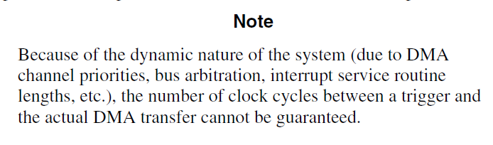

There with a note about eDMA channel periodic triggering:
I call below eDMA interrupt service routine to clear interrupt channel flag when exit eDMA ISR:
Using below eDMA ISR will avoid enter into ISR again before print in while loop.

The note of eDMA just tells me that there is no guarantee when my eDMA transfer will be started after a eDMA trigger signal, but my interrupt gets fired after the transfer is complete.
