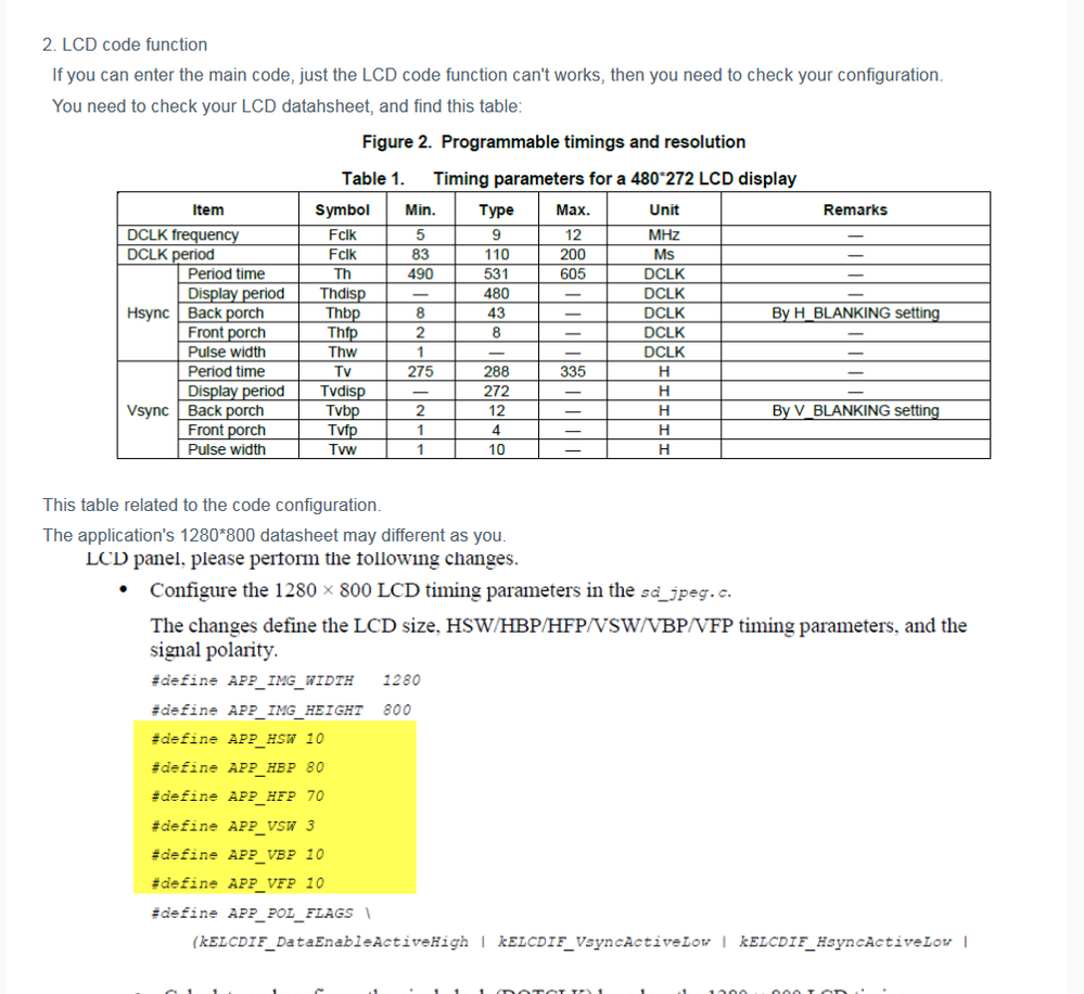

  If you can't meet the target of 60 frames per seconds, it is still related to the HSW, HBP, HFP, VSW, VBP, VFP data of your LCD, I find you are totally use the application note data, but you didn't refer to your own LCD datasheet data.
  In fact, I can't find the HSW, HBP, HFP, VSW, VBP, VFP data in the LCD file which you have shared.
  Still as my reply in the previous time:
   You need to find your own LCD controller related data, then define it in the code, and calculate the related video PLL output clock, and configure it in your project.
   Wish it helps you!

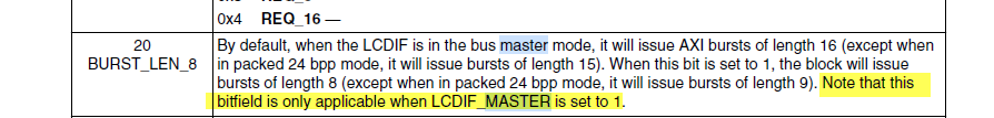

I figured out how to set the master bit, please see below:

kerryzhou
Hi Andre marcus,
 If you search the RT RM LCD register, you will find MASTER is the LCDIF_CTRLn[MASTER] bit.
Kerry

1. I don't think I set master bit to 1; how do I do that, and which register is it?

Also according to the App note: "Configure the eLCDIF AXI master feature register to improve the performance for 1280 × 800 LCD in the sd_jpeg.c. # In the bottom of function “void APP_ELCDIF_Init(void)”, add the line: APP_ELCDIF->CTRL2 = 0x00700000;"
I added the above line of code at the end of my void APP_ELCDIF_Init(void) function, and it just made my code stop running. Any comments on this suggestion?

kerryzhou
Hi Andre marcus,
  If you already prepare the frame buffer, I think you can use the memcpy,You totally can try it on your side.
   About your APP_ELCDIF->CTRL2 = 0x00700000; stop running problem.
 Do you set MASTER bit to 1?
   Wish it helps you!
Kerry
10,363 Views

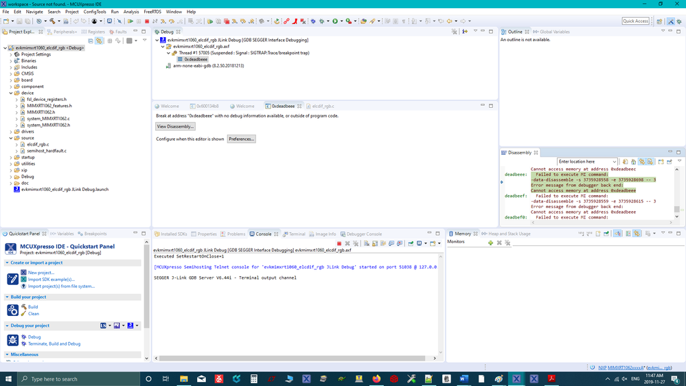

farid_mabrouk
Hello Kerry!!
i managed to solve y issue by disabling CachI and CachD; however, I was not able to meet the target of 60 frames per seconds using the function: App_fill_framebuffer, which uses a nested for loop. Could you please suggest how this code can be optimized for speed. Remember I’m using 1280x800.
   Wish it helps you!
Kerry

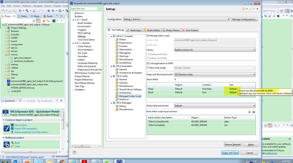

kerryzhou
Hi Andre marcus,
   You heap and stack size is not the same as the application note, please modify the size like the AN, stack size is 0X8000, heap size is 0x800000.
Others, I still need more time to check details, will reply in the next week, because now I already out of work.
Thanks a lot for your understanding.
Kerry

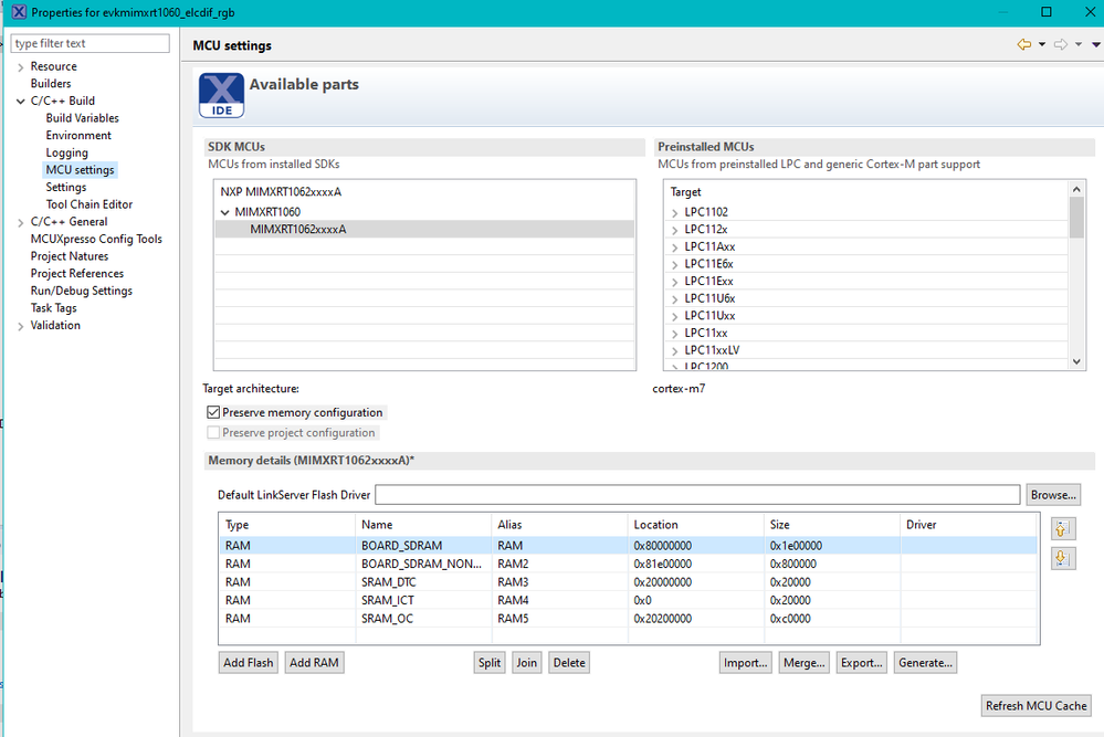

More investigation of the problem leads me to suspect that my main issue is the graphics data that I stored in the Cachable SDRAM memory space. I have 8MB of data per frame and that cannot be stored in the 2MB of non-cachable SDRAM memory space. As I declared  my frame buffer as a global variable, it just got initialized to zero and that's why I am seeing a black screen all the time.
If I need to prevent this frame buffer data from being cached what should I do? the example I was looking at was dealing with a 2MB of data which got stored as non-cachable and that was it.
I hope someone can comment as soon as possible.
Cheers!
10,372 Views
kerryzhou
Hi Andre marcus,
   You can disable the cache, then test it directly.
   Comment :
    SCB_EnableDCache();
    SCB_EnableICache();
  In BOARD_ConfigMPU();
  Then you don't need to care about your non-cachable memory is not enough, just test it to check whether your problem is related to the cache.

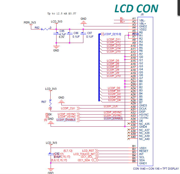

BTW, please share me your hardware schematic, I really need to know how you connect LCD to the RT chip.
Kerry

These are my schematics screenshots
10,372 Views
farid_mabrouk
Any issues with schematics?
10,372 Views
kerryzhou
Hi Andre marcus,
  Could you please give me your RT schematic picture which used to connect your LCD pins?
  I just need to check it, because I need to know which RGB signal you have connected, if your schematic is important, you don't need to send me the whole file, you just need to give me some picture about it, just like this:
Then I can help you more details.
