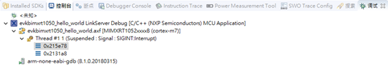

I would to used Qspi flash to boot RT1050 evkb, but be unable to debug and download Qspi flash.

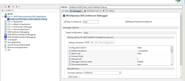

Step 6. Create Link Server Debug
Debug Information:
Result : Thread run ROMCP code, it can’t run user code(0x60002000)

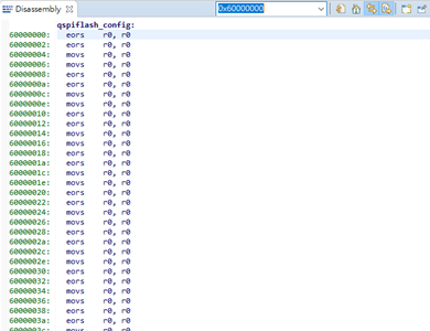

Disassembly 0x60000000(QSPI Flash) address
