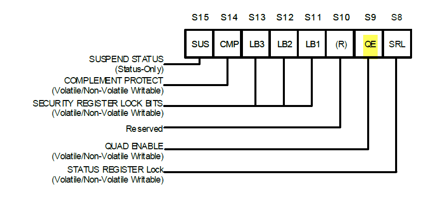

  But, I think you can run this SDK code:
SDK_2.5.1_EVKB-IMXRT1050\boards\evkbimxrt1050\driver_examples\flexspi\nor\polling_transfer
  And modify the QE code like this:
 status_t flexspi_nor_enable_quad_mode(FLEXSPI_Type *base)
    flexspi_transfer_t flashXfer;
    status_t status;
    uint32_t writeValue = 0x0200;//0x40;// enable bit 9 in the status, it is QE bit.

As you know, the Winbond QSPI QE bit is S9
This is different with IS25WP064A.

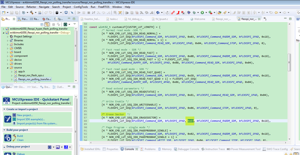

You also need to erase sector, in the customLUT array, you need to change the 0xD7 for 0x20.
You can also change the size with 0x52 for 32KB or 0xD8 for 64KB block erase.

1) Can I use MIMXRT1050_SFDP_QSPI.cfx instead of IS25WP064A.cfx? From driver file name, it seems a general purpose QSPI flash driver.
2) "You can also change the size with 0x52 for 32KB or 0xD8 for 64KB block erase."
Do you mean in the customLUT array? Can you show me which LUT command need to change?
8,829 Views
kerryzhou
Hi Felix Shih,
    1) Yes, the MIMXRT1050_SFDP_QSPI.cfx is the general purpose QSPI flash driver, you can try it.
    2) Yes, it is the customLUT array, please check the following picture:
You can try it on your side.
Kerry

One small thing to change on this, when writing to both status 1 and status 2 registers in flexspi_nor_enable_quad_mode(), increase the dataSize to 2.
From this:
flashXfer.dataSize = 1;
To this:
flashXfer.dataSize = 2;
